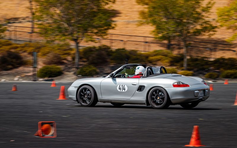

For a point of reference I've autocrossed Nankang AR-1s 235/40/18 front and 275/35/18 rear on OZ 8/9 wheels and stock springs. The outer edge rubbed the fender with 5mm spacers in the rear, no rubbing without the spacers.

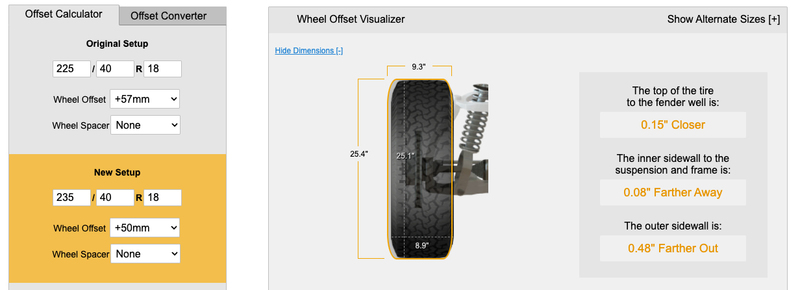

Out of curiosity I ran the offset calculator to compare our set ups.
Our rear set up is identical when you aren't running the spacer (not accounting for wheel width, but with matched tires offset calculators read them as the same width.)
If I had to guess, your set up could be a tad thinner at the fender because your tire is a tiny bit more stretched compared to mine.
58mm stock -15mm spacer (43mm effective) on my wheels.
43mm stock, no spacer for yours.
With the spacer on your rear, you push to 38mm. So by that math, the extra couple mm should let the 275 tire fit without issue on my car.
Here are the fronts.
You're 7mm out compared to mine, with the same width wheel (8inch). I am currently running a 225 tire. With a 7mm spacer and a 235 tire, by these numbers I shouldn't rub. Especially considering you ran your setup for Auto-X, which in my mind would push the suspension to rub if the chance was there.
Main difference is our ride height. I don't know your suspension set up, but I am about 1.5inch lowered so maybe a 3-5mm spacer would be a better choice for me.
So your data was very helpful. Do you have any pictures of your Boxster with the auto-x wheel set up on by chance?

Yeah, your offsets should help your fitment and looks like you should be fine. The AR-1s have a pretty wide section width so that would also help your fitment based on the tires you're considering. I have a pretty aggressive alignment with 2.6deg Front (GT3 LCAs)and 2.4deg Rear negative camber. That's likely a wash versus your lowering springs.
On the front I did have a touch of rubbing with the wheel liner, but the liners tend to deform over time and can be re-molded with a heat gun.
From this pic you can get an idea as to how tight the rear was.
