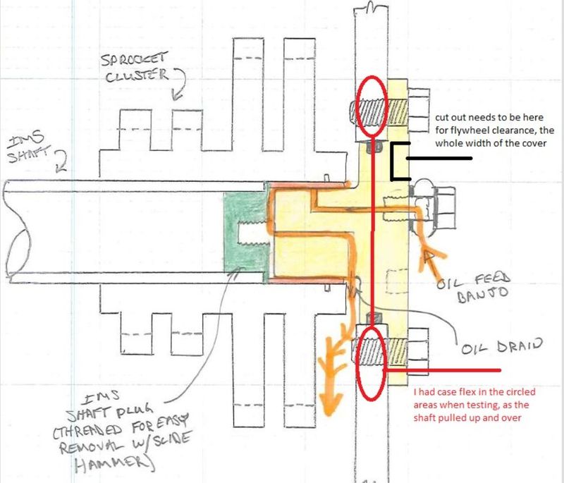

... The Solution is overpriced (and overkill IMHO), but at least there`s no reports of any of them failing yet.
I'm just now reading up on an old Pelican Parts Forum thread from 2012 where this guy Tim, going by the handle 'feelyx' developed the same type bearing as the LN "solution" and said he could sell the bearing for $200 plus $50 for the oil feed setup. So, yeah. way overpriced. I'm halfway though the 18 page thread. Very interesting.
Who has done an IMS change (New Oil Fed Design Idea) - Page 9 - Pelican Parts Forums

That is absolutely nothing like the IMS Solution, regardless of what he describes as the cost. It uses a steel insert in the shaft and a ball bearing in the flange, and is held together with a center bolt. The Solution has no ball or roller bearing components.
Yeah, remember that. A super lengthy post about basically DOF with a ball bearing. Solution is a plain bearing with DOF.
No, he doesn't use ball bearings. Did you read the thread? It's a solid bearing.
I believe I saw on rennlist that he sold his patent to Jake Raby, which linked me to the aforementioned thread.
Read page 7. Post #126 actually has photos of his prototype. On Page 17 he says he can't talk about IMS anymore because he sold the patent. This was 2012. In 2013 LN introduced the "solution".
EDIT: My bad, somehow the prior link sent you to page 9 where he talks about a DOF to set of ball bearings instead of the bushing. He was working on several versions at the time, including a grease-fed bearing.
Use this link:
http://forums.pelicanparts.com/boxster-cayman-forum/649905-who-has-done-ims-change-new-oil-fed-design-idea-7.html

Yes, you are right about the bearing, the plain version shows up indeed in this thread.
