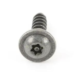

Does anyone know the part number for the two screws that hold the mass air sensor down for a 2001 Boxster? I dropped one into the abyss and need to replace it.
Also if you know an online source for these screws it would be much appreciated.

The part number for the screw is 99991916007

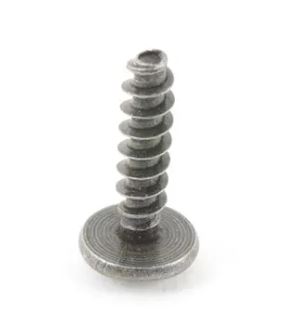

Originally Posted by Keith Newby View Post
I'm not quite sure what those screws look like but Marshalls Hardwar in Miramar stocks just about anything you'd need.
This is what the screw looks like.

Note that this is a 6- point TR torx, whereas the screw holding the maf on my '03 S is (was) actually a 5-point TR torx. Seriously? Why would ANYONE do that?
Standard torx is fine. Sorry I don't recall the size.
Interesting, on my 03 Boxster S, it's a 6 point TR torx screw. The torx bit I used has CR-VT20 on it.
