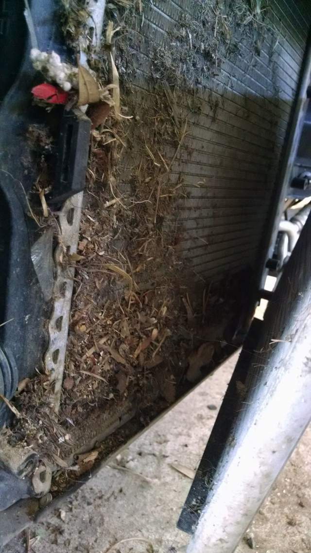

Second thing was that the temperature during my first and only drive so far stayed just over 180 degrees but if I sat for a bit, it started to climb. And the litle red light just to the right of the 240 degree mark kept blinking. So i took off the bumper (thanks again to Youtube) and cleaned the radiators. See attached photos. Did not check the fan motors themselves but will do so before reattaching everything. Will take a couple of days to do that as I will be repairing the plastic vents first (a lot of cracks). Am thinking of fiberglass for the vent repair.

FYI, your coolant light blinking has different meanings... a slow blink (1/ sec IIRC) is an indication of being low on coolant. check your coolant tank in the trunk when car is cold. Do not fill to the top (full line). 2/3 of the way up is fine.
A quicker blink is an indication of coolant approaching overheating range. Light on solid and you're overheating.
I may not have this stuff exactly right so search to be certain.
