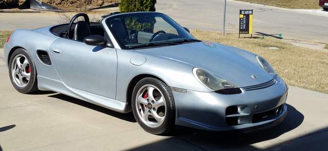

I just bought my first Boxster and I am thrilled with it! I've owned a few old VW's and 914s, but this is my first "modern" (it's a 1999) fun car.
The car is in pretty great shape considering it's age, but there are a few annoying things right off the bat I would like some advice on.
1) The key won't lock or unlock the doors....at all. The LED light comes on on the remote, but doesn't do anything. Plus, it's really strange that turning the key in the door lock doesn't do anything either.
2) The back window vinyl was replaced by some genius PO with material that you can't see out of. Looks like they just sewed it in. Would it be advisable to remove this and replace it with something I can actually see through, or should I buy a complete replacement top with good vinyl (I see they may be cheaper than getting mine fixed)?
Thanks in advance for all the help.

Nice areo kit. Looks sharp.
For the lock, the immobilizer (under driver's seat) may have been wet before. It controls locks. Common problem.
GT3 front bumper, blacked out amber turn signals.
