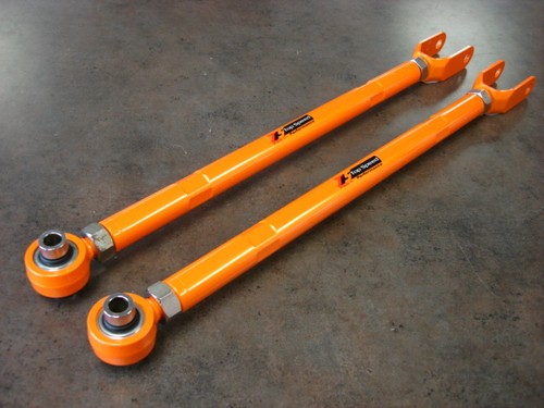

Randall I'm curious if you used the 987 part number as Brad mentions it's better, but never stated why.
Also healthservices posted these. Wonder if they would last longer?

Kram, I used the 986 parts numbers on my parts. Not sure why the 987's might be better... didn't know they fit my first year boxster.
I've just removed the adjustable toe arms front and back from Top Speed along with my Ksport Koilovers in an attempt to make the ride nicer and get rid of rattles.
Those orange adjustables are 1) HEAVY (made of steel) and 2) may well make a racket just as quickly as the factory style aluminum ones from Porsche.
I'm done with aftermarket parts on my Boxster, but I don't blame others for giving them a try or even being happier with them than factory parts.
