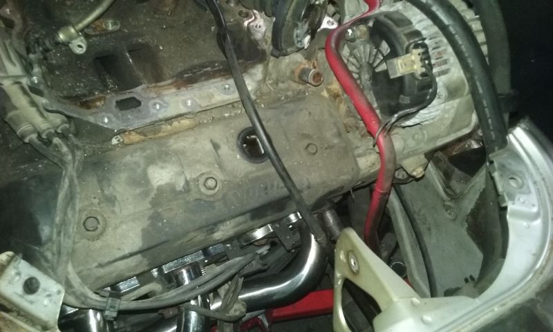

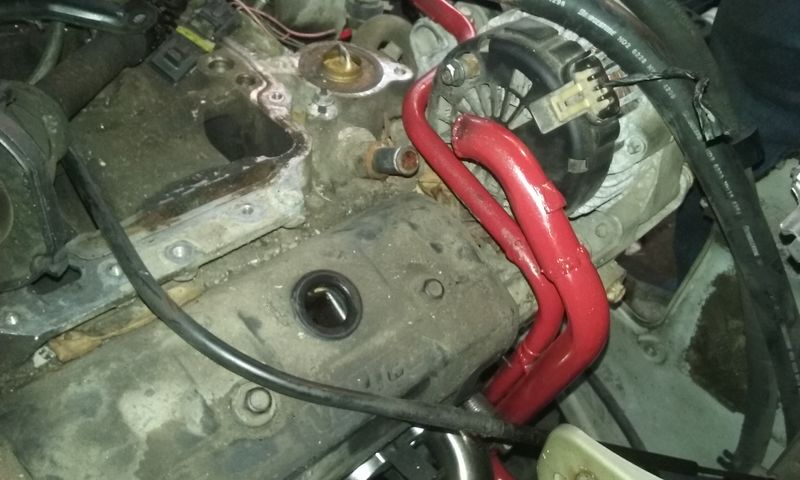

I did cut out this portion of the firewall. Hoooooo boy what a smell when the grinder met the old sound deadening material. It might also be my grinder is 60 years old and ready to retire.

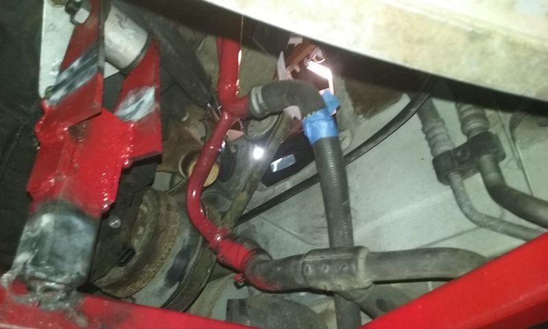

Do any of you guys know for sure if these are the P/S hoses? They are right behind the drivers seat. They snake under the A/C compressor.

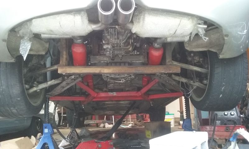

I don't really want to flood this thread with needless updates so I've stayed away for the moment. But the engine is out and for sale if anybody wants a boat anchor or coffee table. LOL
Seriously I think it might be a "re-builder". The oil filter didn't seem like it had an excess of metal shavings... IDK Doesn't matter
The Harbor Freight engine hoist which normally is quite inadequate when it comes to length did VERY well here. Just used a long chain and whola the engine is free.
