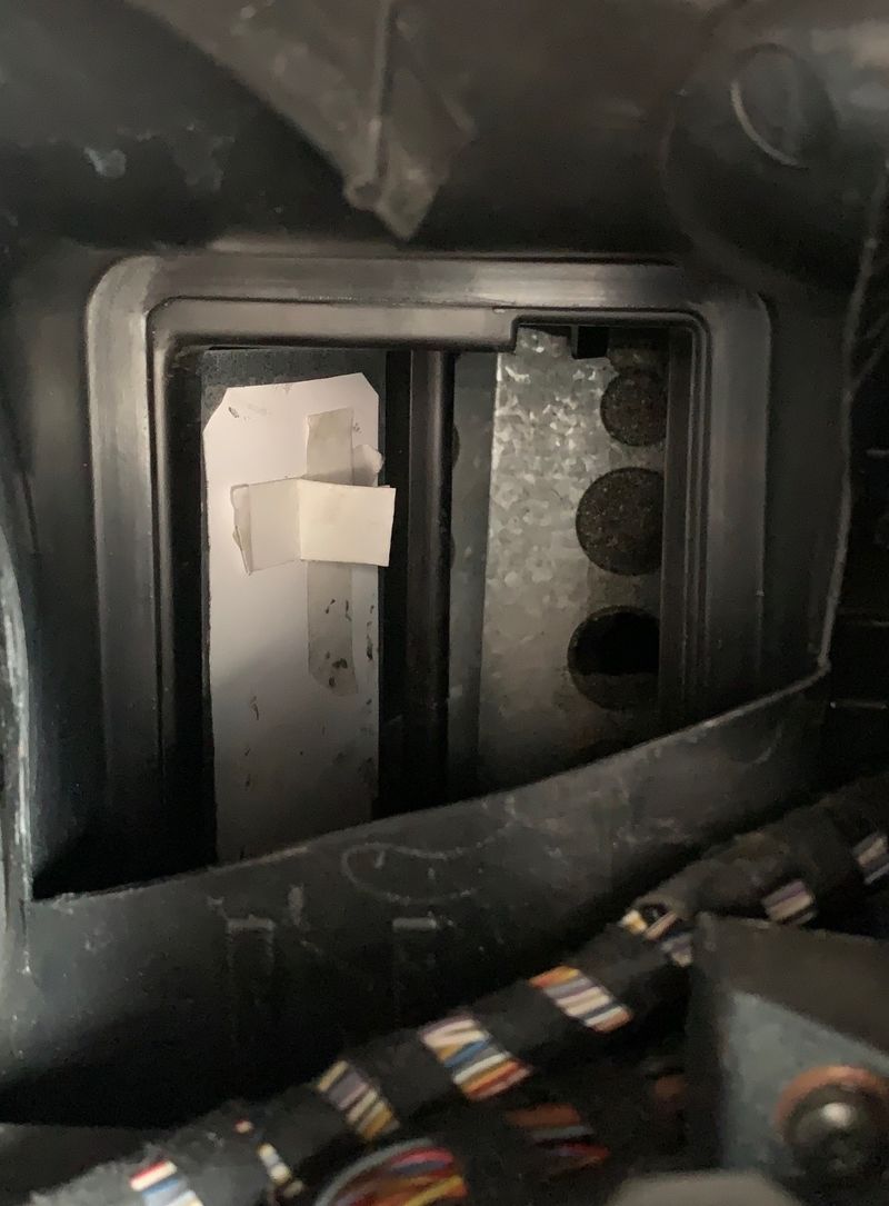

1) Instead of cutting the sides of the snorkel-like duct and folding it down I cut the bottom as well and removed the cutout completely to simplify the operation and have more room.
2) I worked with the first door partially or fully open rather than fully closed as shown in the video. This gives more room to get a hand in to remove the old foam and the access to the door is just as good.

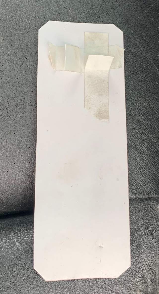

3) Instead of using tape or foam I used a piece of thin aluminium that I JB welded to the door. The advantages of are that the aluminum is easier to control than tape when maneuvering it into place and before the JB weld hardens the patch can be slid around to place it accurately. With the door fully open it is easy to feel how the patch is placed at the bottom and on the sides.
I stuck a couple of pieces of masking tape with a fold in the middle onto the patch to act as a handle during installation.

I finished my Boxster S without major problems. The whole operation is less complicated than it seems before starting, even if there are a lot of things to remove in the frunk.

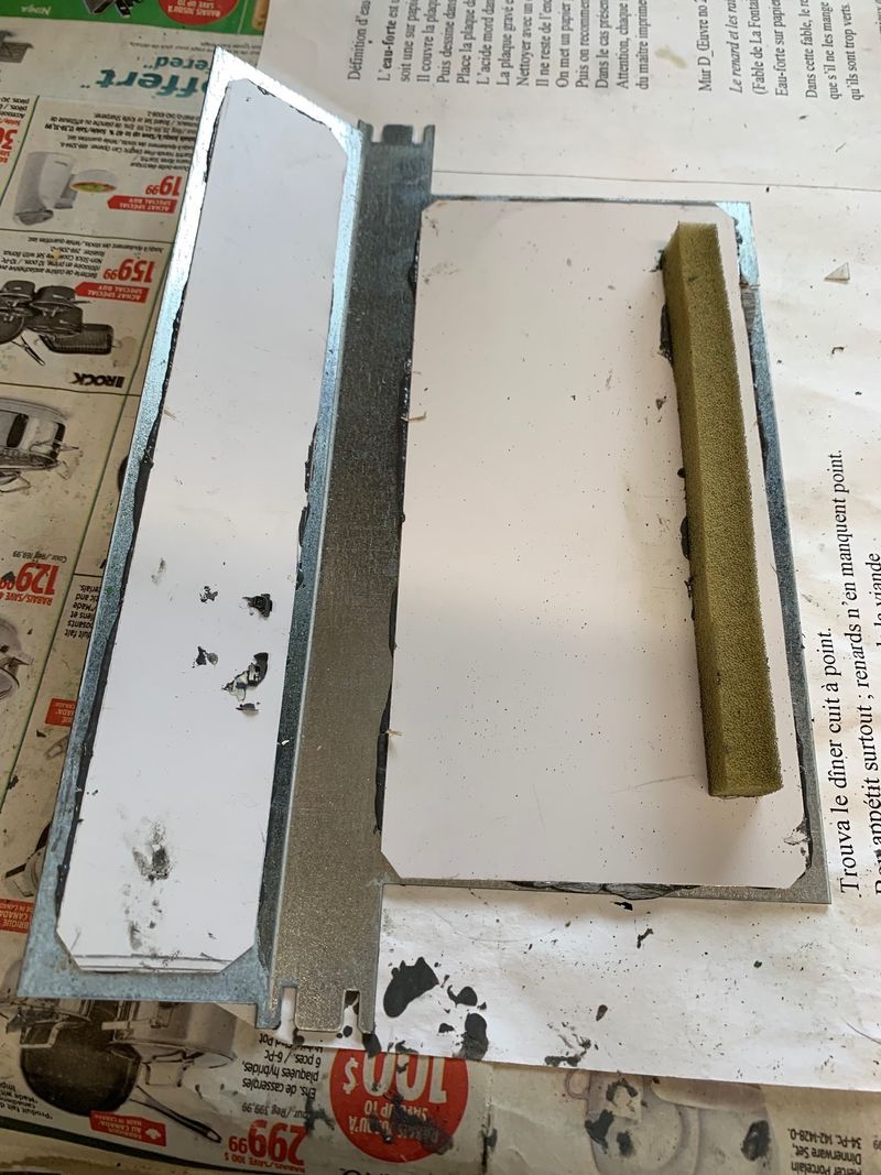

Yesterday I started on my Boxster base. When I got eyes on the front blend door I thought I was wasting my time because the foam looked like it had been replaced already, then I touched it and it turned into powder.
So this is where that long piece of foam I found in the driver's side window vent on the other car is supposed to go.
When rempving this door I had a problem separating the door from the bottom clip (that is accessed from the passenger footwell), I was able to release it using a long screwdriver from inside the frunk.
Other than that the repair was the same as previously outlined for the S.
Dimensions for the aluminum patches that I used are 2 3/4" X 6 1/2" (rear door), 3 1/4" X 6 3/4" and 1 3/8" X 8 1/4".

Grant,
Are you able to provide any detail on the raised grey section of foam on the right hand side of your photo? I have never seen this addressed before in blend door repair discussions. Possible function and dimensions?
Thanks,
Rick

Originally Posted by gdotcvg View Post
Grant,
Thanks,
Rick
I think most people don't find that piece because it is gone somewhere in the ducting. The second video that I linked to above, by Yogi, shows him recovering it from his driver side window duct... like me. Since I now know where it goes I stuck it on my repaired door.
I didn't think to measure its position, so just estimated based on the picture.
