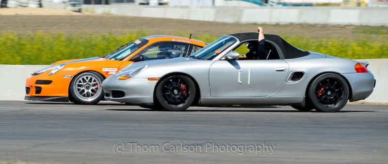

and here is what that looks like with 235/40 R18 on 8.5" ET 53 and 265/35 R18 on 10" ET 40 wheels. getting passed by a cup car.

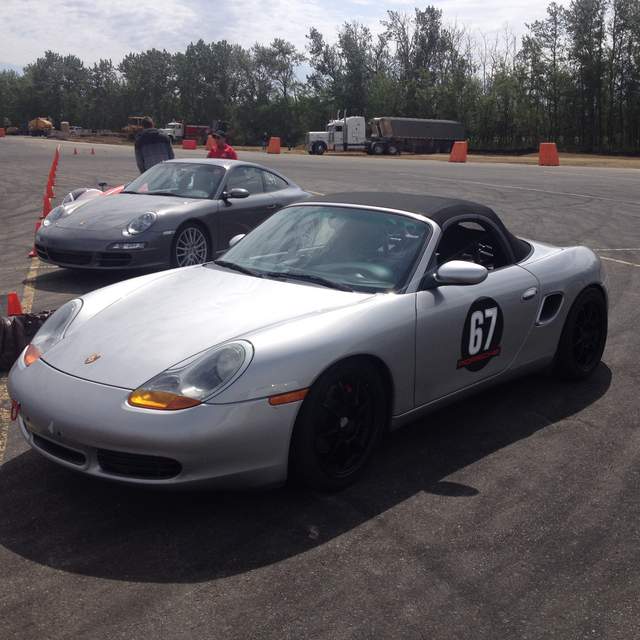

Posts: 3,190
and if the painter tape numbers are too ghetto, here is the improved magnagrafik magnetic number version ...
in this pic you can see that there is still some space in the front (easily 1/2" / 15 mm) so was thinking of moving to a 245 in the front with a 7 mm spacer.
