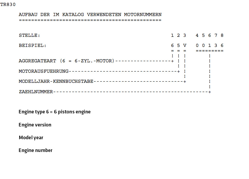

Also,maybe someone can enlighten me regarding my engine. I read somewhere that if you have an x on the engine no,than the engine might have been changed by the factory. My engine number is M96/2065x14718. Does that mean my engine had been changed at one point?

http://www.renntech.org/forums/topic/39974-engine-identification/

Thanks for the link. I had read something already about the letters AT being rebuilt engines,but I don't have AT, I just have an X as a letter in between the other numbers. Does that also mean a rebuilt engine? I need to know so that ill know which bearing to order. I think I read something about an x being at the end of the vin number,but mine is in the middle, so not sure.

Posts: 1,534
X is the model year = 1999
6 = 6 cylinder
5 = engine type
X = 1999
14718 = counting number
Regards
Markus
6 = 6 cylinder
5 = engine type
X = 1999
Regards
Markus
Oh ok, thats good to know. So I should have the double row bearing then
