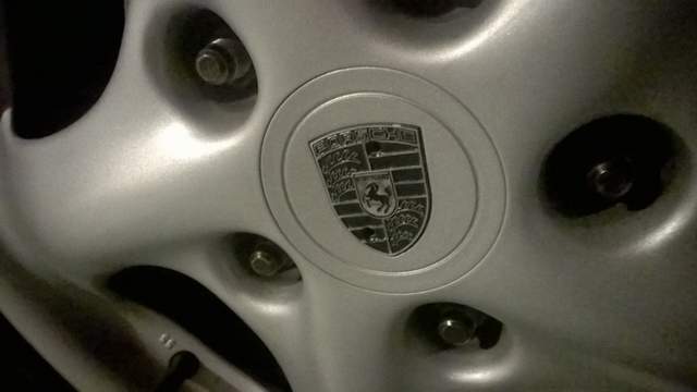

Mine are Tarett 82mm with stock wheels. You may want to check with Tarett to be confirm the correct length with your spacers.
Just so you know, the front studs will stick out beyond the stock front wheel (they will be recessed for the stock rear wheel). This is due to the different size front and rear wheels (but same size stud for both). Some people don't like this look (and it might be minimized by using a front spacer) but I wanted you to know beforehand.

I used pro bullet nose 81mm in front and with 7mm spacers, they stick out slightly less than Tom's photo above with the same wheels.

Seeing those pictures makes me want to reconsider. Wouldn't shorter studs work? I mean, you just need a little more thread than the depth of the nut.
