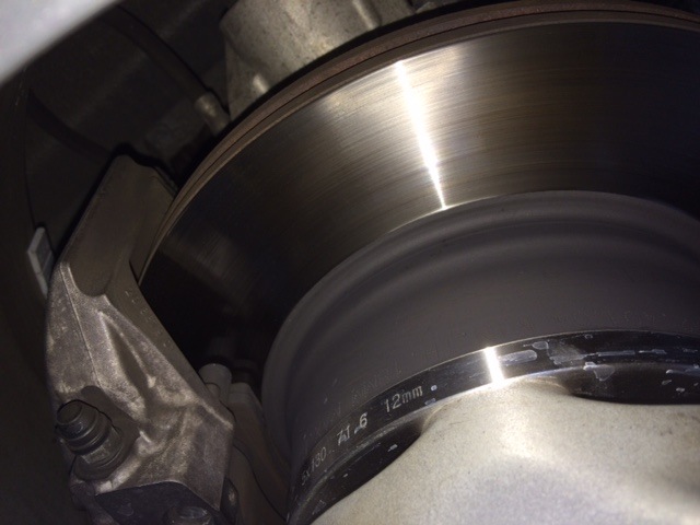

Speaking of rotors, not trying to highjack just got a quick question...Where did I go wrong with these brand new rotors that are rusting? Its just cosmetic but obviously its a serious contrast to the rims and spacer and a huge annoyance Id like to avoid for my future rotors.

Originally Posted by TypeA View Post
[SIZE="2"]Speaking of rotors, not trying to highjack just got a quick question...Where did I go wrong with these brand new rotors that are rusting? Its just cosmetic but obviously its a serious contrast to the rims and spacer and a huge annoyance Id like to avoid for my future rotors.
Next time get rotors with painted hats and they won't rust out like these.
Give them a light sanding and then spray paint with Barbeque or high heat black - mask off the rotor as much as possible - the brakes will clean off any small amount of overspay.
What make are they? I'm hoping my Z Coat rotors will look good for a while.
