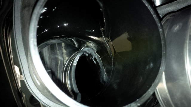

Hello,
When starting the car began to smoke, and I remove air intake and found therein oil I bought a new air oil separator and smoking stopped at startup. After about 1000 km appeared white smoke while driving. At a moment when the car began to smoke in white, started flashing CEL, now only lights. Now I disassembled the air intake and again found oil. It looks back on air oil separator. Is there any reason that could have a new air oil separator destroy?
Thank you!

How does the white smoke smell?
Did you check the car for error codes?

There seem to be 2 things that are the 'final straw' for a weak AOS diaphragm:
1.overfilling the sump
2.tracking + 1.above.
Are you sure you did not overfill ?

Diagnostic returns P0410 and P1411

There is a simple test for AOS failure- try removing the oil-filler cap and test the vacuum."Search" 'slack+tube+manometer'.
I hope you have somewhere warm to work on the AOS replacement- tedious job.

Thank you, I'll do a test vacuum. Oil-filler cap can be removed very difficult (made before installing the new AOE and after installation too), it can be a symptom of the loss of vacuum?

It sounds as if your vacuum is normal. The difficulty with overcoming the vacuum when you try to remove the oil-filler cap indicates that the diaphragm of the AOS has failed.
Suggest you " Search " AOS failure before you proceed -it is a frequent subject.
