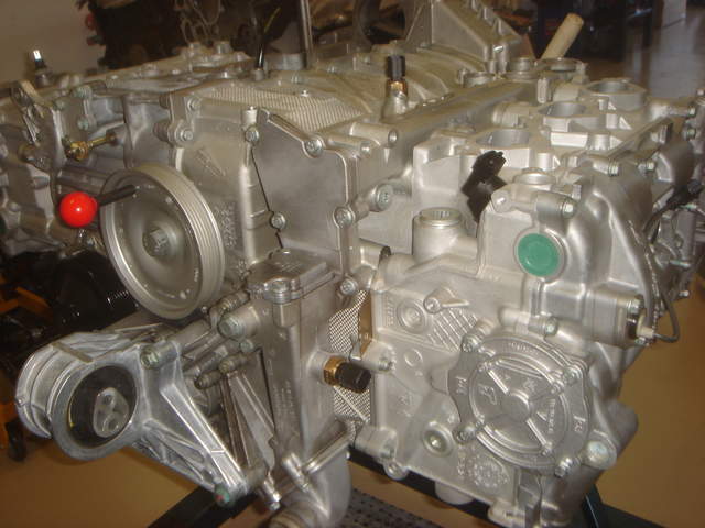

That looks just like the tensioner I inspected. What tensioner do I need to remove in order to take the cam gear and chain off the drivers side head?
Also what is the "test" for the lifters? I will submerge them in hot oil, but is there anything I should look for, or is there a certain amount of pressure they should be able to hold?
The 4-6 cyl. chain tensioner is on the top side of the head. In the picture below it's next to the cam position sensor. It's under the A/C compressor.
Let the lifters "cook" for a good 8 hours at about 250 degrees. Press down on the plunger to purge the old oil, you will see dirty oil squirt out, keep pumping until no more dirty comes out & the plunger gets too hard to compress again. You might need to add a quart of Marvel Mystery oil to the pot.

This is the tensioner below the A/C compressor.
Does that seem to be a bad wear pattern on the side? It is only worn on one side.

I did notice the tensioner below the a/c compressor for cylinders 4-6 had definitely more play in it than the tensioner near the oil filter for the IMS chain. Is this normal? They are two differnet styles, but the one closest to the IMSB and oil filter I could barely move by hand. The tensioner for the cylinders 4-6 chain I could move from a standing 3 5/8" down to 3 1/8" using just the palm of my hand.
Due to the wear & inaccessible location of the tensioner, I would replace it.
