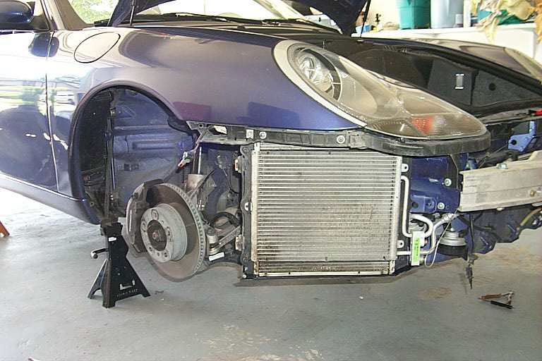

From the front to the inside of the left rear tire is a broad range. Where is the marble size hole? Is that where the coolant appeared to come from? Can you post a picture showing damage?
The coolant tank is in the right rear of the trunk. Hoses and metal tubes lead from the front of the engine to radiators, passing along the inside edge of the front wheel wells.
