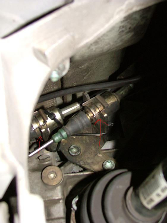

Ok, bought a jack today and took a look:
It seems that the bottom most one is out of place. I tried quickly putting it back in, but it is awkward to get at. Any tips?
Also, Is it as simple as that? The top most one seems to have a loose washer as well. Issue?

the brackets in the picture must be firmly seated and the retaining clip should be in place. Best viewed with wheel removed.

These look good to me, shift to neutral to check alignment, but if they are connected I would not change adjustment. Easy to remove console as all panels pull off easily & ashtray comes out after removing T10 torx screw in bottom. Check pelicanparts.com tech info section for good trans repair pics.

Northing is good here. the bottom outer cable is more than half way out of it's holder and the top one is completely out of the holder. It will not shift unless the outer cable is mounted correctly.

So, I had them put back into place, but while driving today they both came out again, which driving.

The retaining clips are easily damaged when removing the tranny cable ends. I'm guessing whoever worked on the car last damaged them and reinstalled the cables without buying and installing new retaining clips.

There are very small detent's in the bracket into which the retaining rings must be inserted, You may have to bend them to hold in place or purchase new ones.

986 424 411 00
OEM-98642441100 Retaining clip, mount, cable, for 2 $3.75
