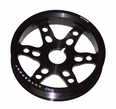

update:
got my car back, installed new water pump, engine mount and LN thermostat,
my car feels like a different car!
highly reccomend the low temp thermo, car runs alot cooler, so i think the ecu runs more aggressive ignition timing.
problem i had was with the underdrive pulley, my mech says its totally wrong for my car, even with shaving down the boss
gonna take it to another guy for a 2nd opinion.
need to know if anyone has fitted the new style BBI pulley see picture
dsisco is offline   Reply With Quote

[QUOTE=need to know if anyone has fitted the new style BBI pulley see picture[/QUOTE]
Yes I installed one, works great.. don't know what your guy reffered to other than the fact it's harder to hold when you tighten the bolt and does not have any TDC marks on it. Just keep your old pulley in case you ever need to do cam timing or install the LN eng IMS.
I am using the BBI pulley on my vehicle with no issues whatsoever. Tell your mechanic that he is far afield on this one .
JD
p.s. Its important to know, that a shorter belt is required to accommodate the smaller pulley.
