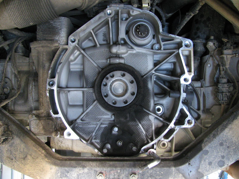

We installed a new clutch and light flywheel, old was worn down to the rivets….crazy I know. Front Motor mount was busted, installed the 987 update. And since we were in there, we updated the RSM seal and checked the IMS, looked fine.

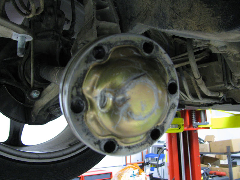

Anyhow, it turns out the clunk, cluck noise was coming from a axle cover that connects to the transmission. For some odd reason, no idea how, maybe previous owner, the cover was dented and cut into…really odd.
My car drives like new now, smooth and quiet. Such a big different!!!
