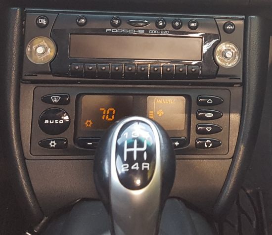

I don't believe any 2x7 radio will fit into the lowest part of the bottom center console. It is simply too big to fit into that cubby area. I re-located my radio during a trial and uploaded a pic so you can see why it wouldn't fit.
The screen viewing angles will play another factor where you want to put it. You will need a unit that has custom viewing angle adjustment. You will also be dealing with glare from the light when your top is down at that placement position.
You should listen to the others in 2014 and move past the single DIN. These units cost more money than DDIN on average and will fail quickly over time. It is outdated for 2020 even for our Boxsters. The DDIN setup will give it a cleaner OEM look.

Posts: 135
I confused myself. My HVAC control is on the bottom as shown and I pictured my setup while reading your issue. I thought you wanted to install single DIN flip at the bottom bay while moving up the HVAC at the same time which to me made no sense . There are several uses for the 3rd bay. CD storage tray, cassette tape storage (yes I know), storage cubby, HVAC, and temp gauges.
Your HVAC climate control is at the top bay from factory. You need to do pull the wiring harness down to the 3rd bay which shouldn't be too hard. Most with your setup want to bring it down to where I have it from factory. I heard that it was a very tight leash. By having the HVAC at the bottom bay it looks more uniform. It's like the two cubbies at the bottom like your setup or radio/cubby/cubby/hvac.
I suggest you remove the entire lower cubby storage. It's 5 mins total. Wear some gloves or your hands will be scuffed up.

I did complete the move and have not posted the results....I ended up cheating by removing the psssenger side underside panel and hvac duct and then tried two different routes before I was able to get harness to reach. I used painters tape to smooth the connectors and harness to push it through the triangle of doooom. Unfortunately, I have to do a shoulder stand and reach up behind the radio to release the radio connectors for radio removal......not fun.
I ended up practicing yoga so that could I do this job...
