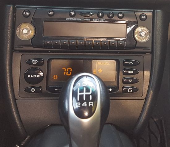

clickman 08-16-2020 11:23 AM
Reviving this old thread. It's time for me to upgrade from my iPod Classic thru the CDR220. Too much squinting down at a tiny screen - usually unsuccessfully - while driving down the road. I'd like to go with the double DIN touchscreen but the idea of moving the HVAC controls back down to the bottom doesn't excite me (I moved it up when I scotched the factory cupholders). If I have to move the HVAC down, I'd much rather put it into the spot one up from the bottom, but I haven't found a way to do that.
So... has anyone a single DIN flip-out multimedia unit? The screen while out covers the HVAC, but maybe the temporary retraction is seamless while fiddling with the HVAC? Does it cover up much of the vent? What about the stability of the screen while extended? Any other feedback?
Thanks, Norm
PS I'd like to stick with my current amp and speaker arrangement (dash, door, rear); I have replaced my 4 channel amp with a 6 channel from a 996, and replaced the dash speakers when they crapped out.

clickman 08-17-2020 10:43 AM
Thanks for the feedback but I'm a little confused by your answer. The only use for the 2nd-from-the-bottom position would be for the HVAC controls if I can figure out how to do that.
If I went with the single DIN it would go where the factory single DIN is now.
1PorscheBoxster986 08-17-2020 01:22 PM
I confused myself. My HVAC control is on the bottom as shown and I pictured my setup while reading your issue. I thought you wanted to install single DIN flip at the bottom bay while moving up the HVAC at the same time which to me made no sense :). There are several uses for the 3rd bay. CD storage tray, cassette tape storage (yes I know), storage cubby, HVAC, and temp gauges.
Your HVAC climate control is at the top bay from factory. You need to do pull the wiring harness down to the 3rd bay which shouldn't be too hard. Most with your setup want to bring it down to where I have it from factory. I heard that it was a very tight leash. By having the HVAC at the bottom bay it looks more uniform. It's like the two cubbies at the bottom like your setup or radio/cubby/cubby/hvac.
I suggest you remove the entire lower cubby storage. It's 5 mins total. Wear some gloves or your hands will be scuffed up.

azlvr 08-25-2020 05:53 PM
I put my HVAC in the 2nd from bottom location because I had a full leather cubby in bottom and didn't want to loose it plus HVAC is easier to adjust in that location. Sorry I don't remember exactly how I did it.
