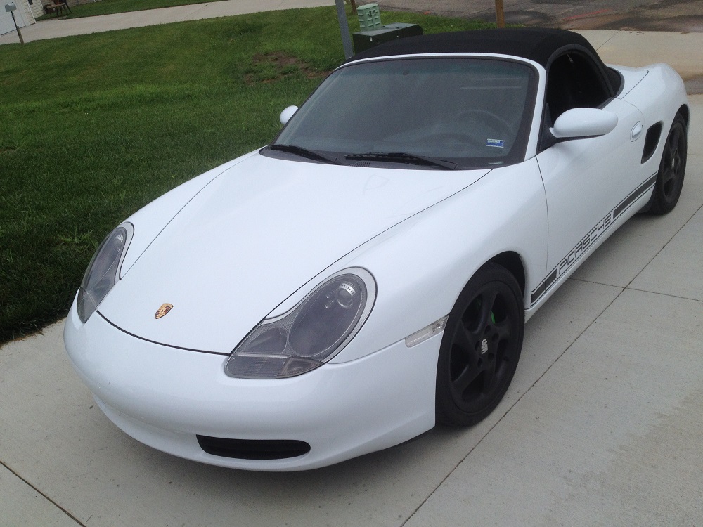

particlewave 07-20-2014 07:39 PM
Originally Posted by embryoguy@mac.com (Post 410586)
i hate your white car, its so much better than mine ! haha
Ha! It's got its share of flaws when you get up close and personal...very much a work in progress, but thanks :)
I still don't have the LED projectors or CCFL DRLs hooked up, but I like this evening shot.
