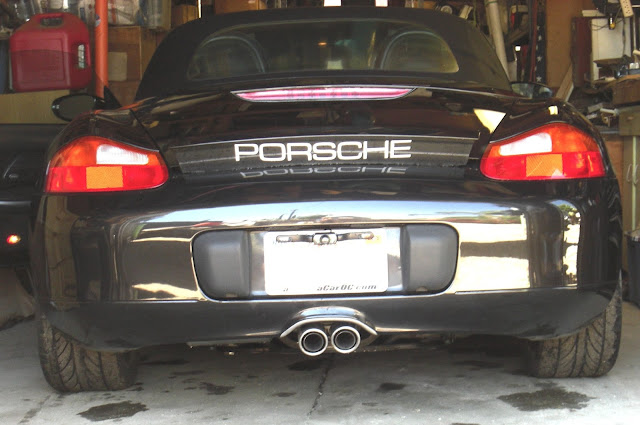

Here are a few pics:
Here is what I got for $320. Muffler, 4 bolts/nuts/washers, stickers and lic plate frame. Porsche 986 Boxster 2 5L 2 7L Boxster s 3 2L 97 04 Performance Exhaust System | eBay
Adjustment spacers at the attach bracket to get the tips to stick out a bit farther.
Need to adjust pipes alignment slightly

That looks really good. Where did you buy it from? and did you install the cat bypass pipes as well (as in BruceH's pictures at the bottom of the thread).

This is the same exhaust that is all over eBay UK and typically buy it now £299. On boxa.net you will also find a load of owners who have this with/out the manifolds.
