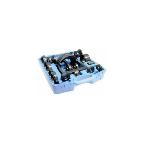

If this is the Pelican one it can definitely pull the hub:
Hub/Bearing Extractor and Installer Porsche Kit PELTOLSIRB90P2 - SIR Tools - PEL-TOL-SIRB90-P2 | Pelican Parts
Yup - apparently the previous version didn't include the part to pull the hub - here's the text from the review of that part from their site and I just noticed it was from 2012:
This makes it easy, needs a hub extractor. Overall this tool works great for the bearing removal/installation and hub installation. I was amazed at how the tool pushed and pulled cleanly. For this, the SIR should get a 5, but.... The lack of a hub puller is a glaring ommision. The 911 has existed for almost 50 years. Why SIR tools can't figure out how to make a yoke/adapter that pushes on the face of the bearing retainer is beyond me. This is really the PITA task, and took several hours and ultimately a rented 5 lb. slide hammer and a 1-1/4" socket (as the hub driver) For this, I can't give SIR a 5. They (or someone with a good laser cutter) need to make a plate, that lets you push on the retainer.
So I take it that you have this kit and can do front and rear?

I have the kit and have done the rear and am about to do the front.
Pelican shows it wrong on their website in Figure 16, when pulling the hub there is no backing plate used, just the big 27mm nut that is used to counterhold the back when you are turning the 24mm nut on the front side. I made that same mistake and twisted the end off my 3/8" breaker bar. Luckily the tool is much stronger than a harbor freight bar...

Ok - I guess I should just order the Pelican kit - if it can do both size bearings. It's much cheaper than the master kit - which has a bunch of different size plates.

Front bearing:
Pulling hub - good, same as backs
Pressing hub - good, same as backs
Pulling bearing - have to use the same plate as pressing the hub, fits the inner race, we'll see
Pressing bearing - press plate overhangs the bearing, but since it mounts flush to wheel carrier should be ok
Since base boxster uses the same bearing all 4 corners and it is the same as the S front bearing, it would suck if this tool is missing the smaller plate to make it work. I'll know this weekend.
