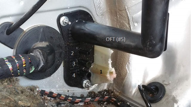

To keep them straight, I numbered the lines the same way that Clickman did in his DIY, referenced in his post above:
#1: The line coming directly out of the tank itself (ie the light colored plastic, the one that does not go through, but rather alongside, the black plate that’s bolted onto the bulkhead between the trunk and engine compartment).
The rest do go through that black plate.
#2: The oil cooler coolant hose. It’s the top of the group-of-three just below the big oil fill tube. This is the one with the easy quick-disconnect a short distance away from the plate on the engine side.
#3: The radiator vent hose, the next one down.
#4: The bottom of the three. This is the one that’s just a passive overflow tubing for coolant spilled above.
The oil fill tubing. Clickman called these #5, but I just followed elgyqc’s lead (referenced in his post above) and called them the oil fill tube (I’ll abbreviate as OFT) ie that rigid portion on the trunk side; and the oil fill hose (OFH) ie that somewhat flexible/accordioned portion on the engine side. Probably obvious, but these are the fat ones mounted above the group-of-three (#2 through #4).
What Pedro calls the “plastic distributor,” and Wayne in 101 Projects variously calls an “integrated manifold” or “oil filler tube/bulkhead manifold” I am, for simplicity’s sake, just calling “the plate.” As mentioned above, it’s the black plastic piece that’s bolted onto the bulkhead and has the nipples onto which the various hoses are clamped on each side.

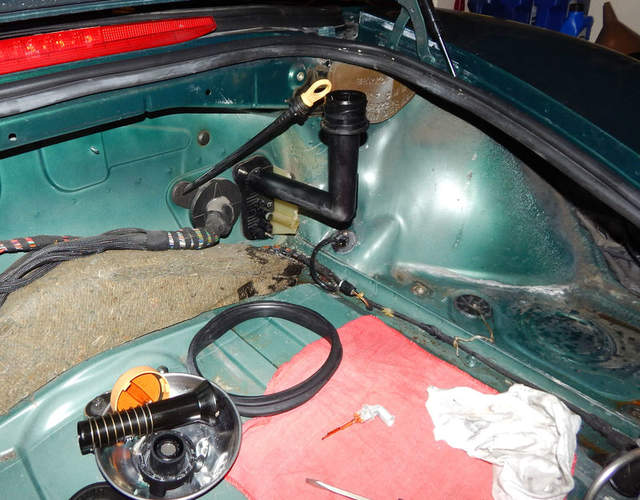

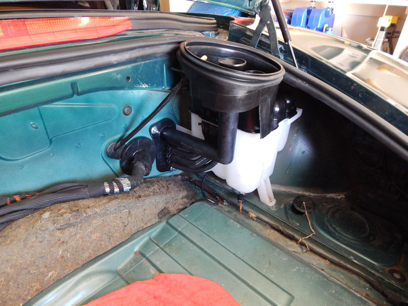

Borrowing the pic from DavesBoxster DIY, looking from the trunk side, the plate (with hoses/tube numbered) looks like this:
It, of course, won’t look exactly like this unless you’ve dremeled away the old tank the way Dave did.

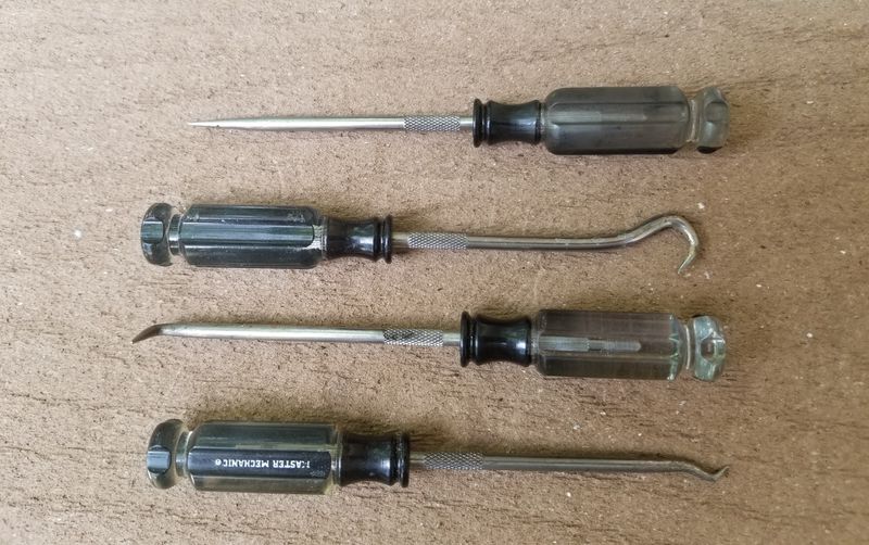

Back on top: I hadn’t picked up any hose release tools, but I did have a set of these from way back:
Using the straight one, I inserted it between the hose and metal piping, being careful to not punch any holes through the hose. Basically I’d insert with the point angled toward the metal and, once I’d gotten it in 1-2 cm I’d start to rotate it, going first one way then the other around the metal pipe, always keeping the point angled away from the hose. Did this for both #1 and #3. Once I was sure I’d busted loose the crud that over time had glued the hoses to the metal, I set the tool aside and just worked with my hands.
It took a few minutes and was mildly painful, but for both hoses, while holding the metal piping I was able to push hard with my thumb and slowly move the hoses off the pipes. As I recall I got the smaller of the two (#3) completely loose, and then (when #1 was mostly off) had my son help: at that point there was virtually nothing else holding the tank in place (we’d removed the 4 fasteners in the trunk), so (as Clickman describes in his DIY) while I held onto the #1 hard piping, my son pulled firmly on the tank and the #1 hose popped off. At this point the tank was free.

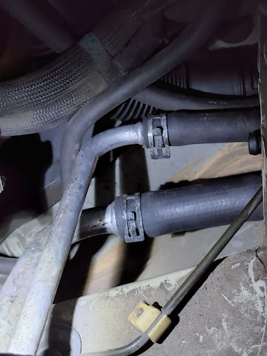

When reattaching the two difficult ones (#1 and #3), with my son working in the trunk and me reaching in from next to the clamshell, I’d lube the hard piping (I’d just dab a little spit onto my finger and then smear it onto them) and then try to get the hoses just started. You can’t get far, because the tank is still a bit too far inside the trunk and it's not like the hoses can be stretched toward the metal piping, so it became a coordinated effort: he’d push the tank toward the bulkhead and I’d twist & push the hoses onto the pipes. It takes both actions at the same time—seems to me that it would be really difficult to do solo.
Once the hoses were on the metal piping, we stopped, lifted the car to standing height again, then reattached the 2 clamps from below. I have to admit, my son was better at this process (clamp attachment) than I; he used a nice German-made tool I had picked up and concentrated on choosing the right plier orientation (jaws up vs jaws down) AND tried to always grasp the tabs on the clamp so that the pliers were in the same plane as the clamp—ie, not angled one way or the other. There's not a lot of room to work, and it takes some patience.
This is the tool I was referring to. It’s a bit pricey (what specialty tools aren't?)—I sorta impulsively purchased them online after having downed a couple of IPAs one evening. But I ended up being glad I did: IMHO it was worth the investment:
Interestingly, I had picked up one of the remote, cable-driven clamp pliers but hardly used it at all. In fact, we only used it once, and that was largely just out of curiosity.
With the car lifted, looking up the #1 and #3 hoses looked like this:
