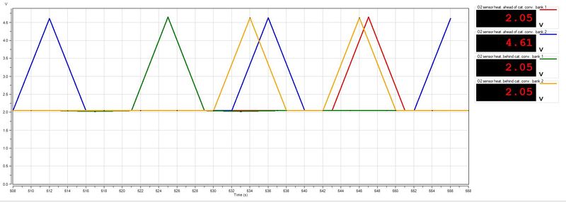

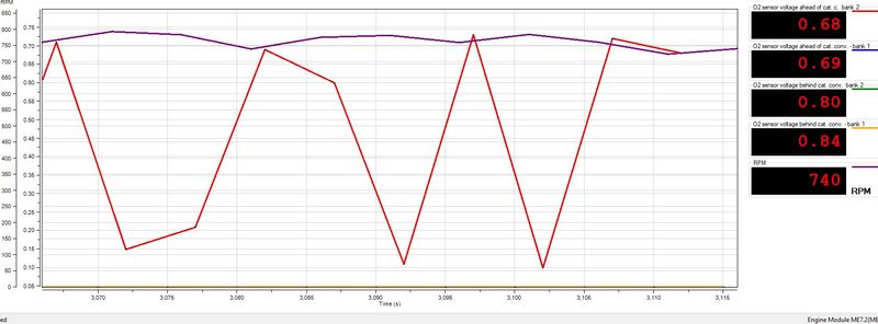

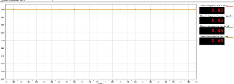

When you get time graph your O2 sensor "voltage signals" for all 4 O2 sensors at idle.
and RPM. Then post the graph so I can have a look see.
They are in actual values under the engine module.
Before you do the graphing go in and click on each O2 sensor "voltage signal" with key on but engine off.
That should show you the "BIAS" voltage on the signal wire.
It should be 0.45V That will test the signal wiring between the DME/ECU and the O2sensor.
Then click on the O2 sensor heater signal again with key on but engine off. This will test the wiring and voltage to the O2 sensor heater circuit. I think the spec. is 4.5V or close to that.
Then get the car up to operating temp. and graph the 4 O2 sensor voltage signals and the RPM.
Just let it idle during the graphing

Here you go. Couple charts from a cold engine:
Without rpm - Easier to see just the voltages

Everything looks good to me with one possible exception.
In the third chart the post cat O2 sensor (green line) should be more like the yellow line.
More steady and above .450mv around .650-.750mv
"BUT" you did the test with a cold engine. The dips could also be from misfires or rise and fall of RPM.
So it could be fine.
When you get time you could test that post cat O2 sensor on bank 2 again as a follow up check or proof.
Do it after a good drive and at idle. you want a graph line more like the other post cat O2 sensor (yellow line)
You may also want to think about the alternator situation you brought up.
I had not thought about that.
Could very well be a factor in the misfire situation.
