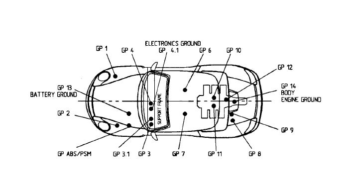

Old 07-27-2021, 08:06 AM   #126
Join Date: May 2017
Posts: 1,180
Coil wiring:
Ground points. Where exactly on the engine is GP 12 though? I know there is a couple ground wires right by the AOS at the corner of the intake manifold, but that isn't what is shown in the diagram. Diagram has it more in the center of the engine, but the throttle body.

Old 07-27-2021, 08:52 AM   #129
Join Date: May 2017
Posts: 1,180
The only thing at 12 is the main ground wire that goes over to the SAI pump. Been looking at wiring harnesses and it looks like the one I mentioned by the AOS & corner of the intake are the ground terminals for the coils and other things on bank 1. That is good & secured to the engine. So if it is a wiring issue it is going to be one of the other wires, a break (unlikely since it does fire) or a chafed wire.
