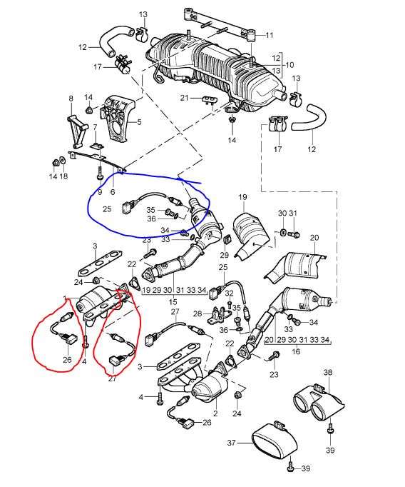

So, let's talk about exhaust & O2 sensors. Are there 4 or 6 on a 2000? I thought there were just 2, at the cat on the header. These are the 2 (red) that I have replaced. Is the 3rd (blue) really there and if so, what is it's purpose? Looks like it is on the secondary cat. And if there are 3, how come only 2 show up in any tester?
Assuming for a moment there is clogged cat. Would it most likely be the one at the header or the secondary cat? Waiting for pb blaster to soak in to get the front o2 removed on the header so my mind is just starting to think 10 steps further down the list.
There should be 4 on stock dual exhaust systems.
1 O2sensor before each precat:
In simple terms they see unused oxygen from the combustion cycle which creates a small voltage.. The DME/ECU uses that voltage signal to adjust fuel trims.
Then you have 1 O2 sensor each side that are post cat.
They are for reading oxygen after the catalytic process. The DME/ECU compares the Pre and Post cat signals to see if the Cats are operating correctly.
So you have 4 O2 sensors total
No way of telling which cat could be restricted
If one is

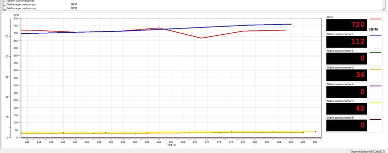

still cant get the front sensor off, it is being a royal pain.
Ironicall, I can get all the header bolts off without any issue and those are the ones that usually snap.
Got the rear o2 sensor out. Made a difference. Still saw some misfires, but in the single digits and they didn't rise like they were doing before and after some time they reset themselves back to 0. Just this test tells me it could be the rear that is clogged.
It does make it easier to do a video though with sound to listen to the idle.
The biggest issue with this car is that it is so damn random. Like yesterday. Ran good last night and then this morning misfires like crazy.

well, can't get the sensor out, but there is a small bolt right below #2 cylinder that was happy to come out. Not sure if that hole is for all cylinders or just #2, but here is a new chart. Also rear O2 re-installed.
I guess the next thing would be to have both plugs where I can remove 1, graph it, then reinstall, then remove the other & graph it, then re-install. I didn't graph it when I had the rear installed cause I was still seeing some misfires but not like in the picture above.

Here is another video to watch. this is with the front plug installed & rear o2 removed. Watch what happens with the misfire numbers. did a video cause the normal graph is just a moment in time and doesn't capture what happens.

So that is bank 1 that has the increasing misfires right after you hold around 1700 RPM
Correct???????
What bank =side is the O2 sensor removed from???????
You need to get the front O2 sensors out.
07-26-2021, 04:03 PM
#9
Join Date: May 2017
Posts: 1,180
everything is bank 1, pass side.
On the header is a small bolt it is right in the tube for cyl 2 before the 02 sensor, that is what I removed. Tried 2 different o2 sensor tools and that thing isn't budging right now. It's going to need some heat cycles to break it free.
Not only do the misfires increase, they reset themselves to 0, and never throws a code.
