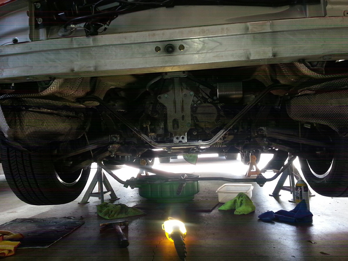

I got under the car this morning... and took a peek from above the engine. There is nothing indicating that any hose broke or sprung a leak. Looks good and dry from above and... from under when looking up there's nothing standing out that says "leak/failure up here".
I'm going to remove the bars and the triangle plate... and give everything a closer examination.
Question: In spite of what I find... don't find... should I drop the transmission pan to inspect the internals? Se if there's anything floating in the pan? New gasket will run me <$20. It's a fresh filter, which I would inspect... and replace if it looked sludgy. However... when I dipped my finger into the road and pulled up a nice amount of fluid... it looked good, just like new. Not burnt. No smell.
Or... should I take a chance and refill (procedurally) the transmission fluid ... don;t drop the transmision pan... and see what happens? Me thinks that I should be looking for what caused the failure...and work on that, or associate it with some serious spirited driving.
I appreciate any advice. Thank you.

Removed the triangle pan this morning... inepscted underneath... looking into the crannies... and see nothing that would reveal as a failure point. Thre is a fair amount of residual fluid that covered everything. However, again, nothing on top of the engine, nor below, that looks like a fail.
I have a couple of question for our members...
1. Should I drop the tran pan... "inspect" the internals... pull the filter and inspect it? Go from there?
2. Refill with new fluid and see what is the outcome?

Pulled the pan this morning... no debris... no sludge...
Removed the filter... no clumps... looks used/new (replaced it ~1,000 miles ago).
I've Googled and Googled... but am findoing no 'vent' or 'breather' for the transmission in the event of overheating. Does it exist on the 98 Tip? Where is it?
Clearly there was a failure point... but I'm not finding it. I've had the lights under and above... the cranny-mirror... and don't see anything obvious. Absent a troubleshooting suggestion or recommendation I'm considering just buttoning it up... filling it up... testing to see if it moves.
Nothing mixed with the oil or coolant. Engine starts.
Given the low miles on the filter would the brain trust recommend reusing the OEM filter or purchase a new one?
In advance, thank you.

Filled the trans pan... plugged it... started it up... and this is from where the leak is coming.
After I identified exactly from where the leak is coming I restarted the car for a moment putting it into drive. The wheel spun, in idle. I'm assuming this is a good sign for the TC.
It appears I'll be taking it to an indi, unless someone believes this is a carport-doable job for someone with zero AT experience.
Advice welcomed, thank you.

That will be the transmission input shaft seal. It does not require trans tear down to replace but the trans will have to be removed.
Thank you, 911. So... just remove the tranny... replace the seal... button it back up?
