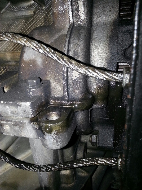

Arrived home around 930. This morning I put the car up on 4 stands. Wiped the fluid that had dispersed underneath... and maybe today I'll move out of the way the aluminum bars... remove the triangle plate... and examine it. Haven't done any reading or research to try to come to a sense of what transpired. However, I suspect it was the 2000 to 4000+ shifts up and down and up and down and up and down. I'm hoping the fluid overheated... blew the pan seal... and that's it. If everything appears to be in order I'll just button her up and introduce new fluid following the proper procedure (I did a fluid and filter service about ~3-4-5 months ago).
If anyone has any ideas about what may have happened... what I should look for... what I should inspect... and/or how to test... I'm all ears.
