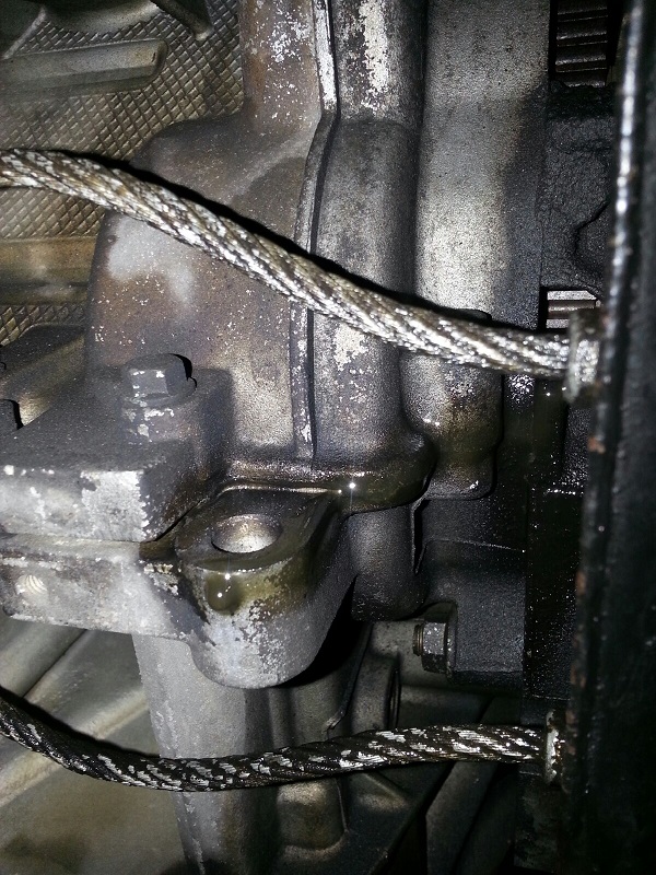

Starter986 10-23-2020 12:18 PM
Filled the trans pan... plugged it... started it up... and this is from where the leak is coming.
After I identified exactly from where the leak is coming I restarted the car for a moment putting it into drive. The wheel spun, in idle. I'm assuming this is a good sign for the TC.
It appears I'll be taking it to an indi, unless someone believes this is a carport-doable job for someone with zero AT experience.

911monty 10-23-2020 03:36 PM
That will be the transmission input shaft seal. It does not require trans tear down to replace but the trans will have to be removed.
Thank you, 911. So... just remove the tranny... replace the seal... button it back up?

911monty 10-24-2020 09:08 AM
Removing an auto trans is a bit tedious since you have to detach the torque converter (TC) from the engine flex plate through the starter hole before you drop out the trans assembly with the TC. Do not let the TC fall out when dropping the trans. Once assembly is removed you then slide the TC out of the shaft tube. The seal can then be R&R'd. Good news is you can dump the old fluid out of the TC and refill before reinstalling. This will result in a complete fluid change. I have attached a thread from the resident Guru (JFP) covering the important details.
