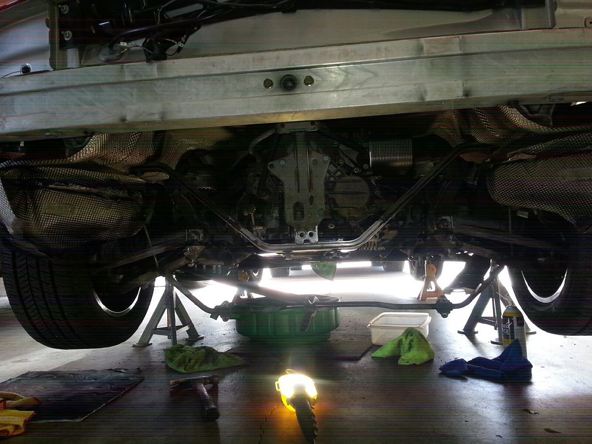

Got the exhaust out today. all in one piece. Those last two bolts... that attach to the muffler (center of picture)... yeah... that was no "Burner" job. I had to remove the rear bumper cover and still use two sockets to remove those last two bolts/nuts.
The six nuts holding on the exhaust to the exhaust manifold... some penetrant and they backed right out.
That muffler is a tank.
Since the mechanic will have to remove the axle I'll see if he can take care of the torn in half boot.
Any other "while you're in there" tasks I should attend to?
Thank you, guys! :cheers:
