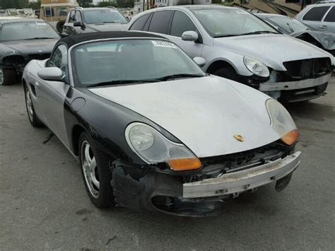

Hi folks,
Does anyone have any photos of the 986 without front bumper off? I'm being lazy af right now and don't want to go downstairs to pull mine off in order to consider mounting options for a potential hitch.

Here is an old thread with two shots of the front bumpers off to expose the radiators.
Radiator replacement: 1998, 2.5
And then some pictures from Pelican Parts for Project 32
Pelican Parts Photos - 101 Projects for your Porsche Boxster: Project 32 - Front Radiator

Just google images of Porsche Boxster radiator.
Here's one that may have what you're looking for:
https://www.planet-9.com/threads/bumper-removal-third-radiator-thoughts-and-porn.91722/#lg=thread-91722&slide=1

Here's some pics of various levels of disrobement:

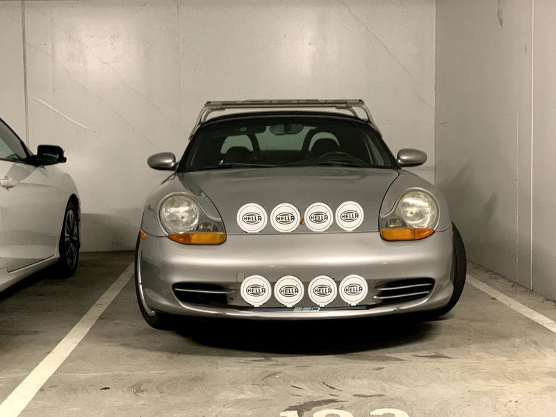

Awesome, thanks so much and this is extremely helpful. I no longer have garage space, so having a clear understanding of what I'm getting into before tearing things apart just to visualize it is great.
The goal is to have an interchangeable accessory system with quick-removal since theft is a serious problem here.
I want to mount a camera slider or alternatively a light bar to the front of the vehicle.
I decided the best course is to CNC attachments to the end of the bumper bar that protrude downward and then secure a bent tube structure with the cotter pin.
Originally I wanted to be able to support 200lbs, so I could add a bucket seat and capture video, but I'm not sure that's doable, I'll have to live with a camera slider
Horrible photoshop example of what I'm shooting for:
Taking some rough measurements and 3d printing a road to check if the bend radius and width is correct:
Fairly close, width correct, radius off by an inchish:
Full assembly design:

Are you dead set on having oval lights? If not than maybe a light bar might be easier to mount and lighter. I have a feeling that those lights will stick out farther than you expect. The weight and distance from a sturdy mounting point might make the lights bounce up and down like crazy. Just another idea, what about installing a third radiator hole on the bumper cover and mounting the light bar behind the radiator using the mounting tabs for the third radiator? Or cutting round holes into your bumper cover and mount the oval lights farther back and flush with the cover?
If you're set on mounting lights in front of the bumper, I would suggest mounting the light support bar either to the radiator support brackets or where the radiator brackets attach to the body
Woody
All super valid concerns, but I am dead set on the classic circular lights. Totally different aesthetic than light bars. The circular lights pay homage to Porsche's rally roots and give a nod to cannonball.
The absolute easiest way to accomplish this would hands down be to use the RTS system mounting points on the A pillar, but again aesthetic.
I'm also dead set on having the completely returnable to stock form, so cutting anything is out. Though I could see how cutting the lights IN to the bumper might actually look very good.
Last, I want to create a mount 'system'. Where I can swap lights for camera mounting, or a jerrycan carrier, or something else quickly and easily. I also want the system to be detachable due to theft (serious problem, my truck was stolen and stripped of its lights and offroad stuff)
I approach these things from a productionization point of view as well. If I'm going to invest 100+ hours in research and $1000+ in CNC tube bending/maching for a prototype. If there is demand, I might make a kit available publicly to try to amortize those costs.

Just ordered a space bumper bar to take measurements from.
Here's what I'm thinking for the mounting system:
beater986 is offline   Reply With Quote

The only problem is I can't stop things from rotating, and having all of that mass of the bar relying on a single point is going to cause bounce.
The goal is still to have the bar removable in < 3 minutes back to stock so it can be thrown on quickly for excursions.
Here's progress:
Light spacing measurements are a bit off, but things are going well. Printing the (hopefully) last version now.
