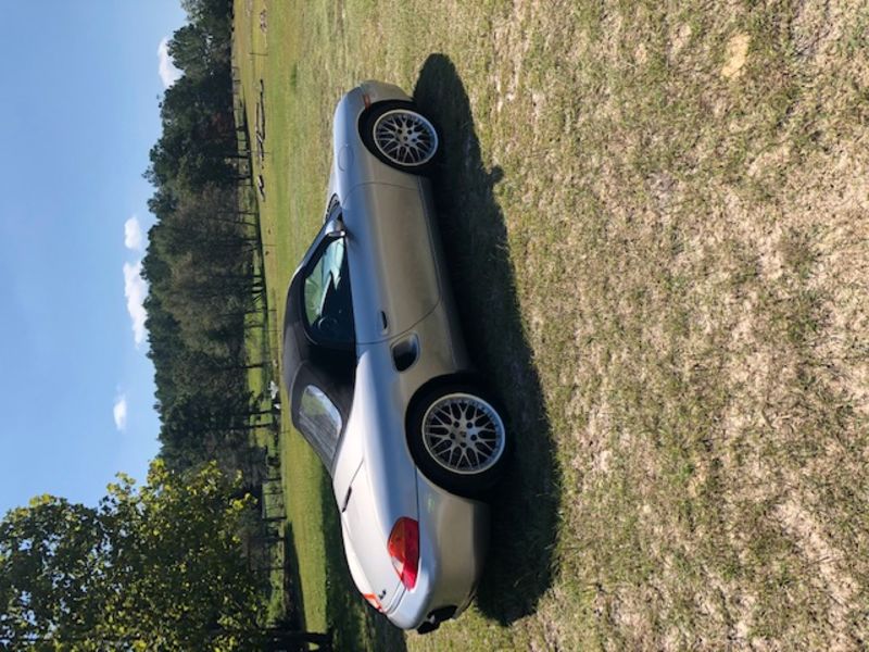

I'll go take a pic and post it. almost looks like it has bead lock for a lifted four wheeler

pic of rim and car. Not even sure if they are original to the 2000 986
absolutely no idea how to rotate. Atleast I got the size pretty good.

No you just need a good tire mounter with decent equipment. Those are optional wheels made for Porsche by BBS. Just make sure you have no air leaks now. That stainless steel band around the rim can be removed & replaced or repaired if it gets dented.
I assume the Hummer has split rims which is 2 halves joined together like a 18 wheeler truck.

They are factory two piece BBS wheels, cost about $550 each:

The 17" version is a single piece wheel. The 18" ones are made by BBS and called Sport Classic II.

The 18" Sport Classic wheels by BBS were an option on the 986 and 996. I had a set on my 996. They are really nice looking but a complete PITA to clean (lots of little nooks and crevices).
You never take them apart unless there is a problem. There is no maintenance. New tire installation, mounting, and balancing is done normally just like any single piece wheel.
