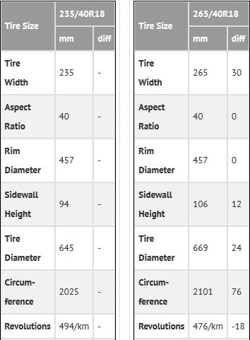

So yes, your mathematics are correct on the rotational speed of the tires. Precision is one thing... accuracy another. Think wrs, me or you would notice? Heck, I'll buy you steak dinner (or tofu if that's your protein) w/ all the trimmings if you could prove to me w/ even 50% accuracy using only your "buttometer" which tire size was on any vehicle w/ variances to this level.
Bottom line, wrs986 came here to make sure what he has works. It does... and well too! Let's encourage him to not fret over this non-issue but instead to get out there and enjoy his new ride w/ those great looking wheels and see what these cars are all about and truly capable of. That's what this should be all about.
You owe me a steak dinner then. When I have to go from Summer to Winter tires I can tell a big difference in the twitchyness of the car. The front tires are smaller in circumference and turn in very quickly and the rear tires turning at a slower rate are trying to catch up. I absolutely hate the front tires spinning faster then the rear tires, especially in a mid engine car and I can tell the difference, very unbalanced.
This is what he is having to deal with when he could have the above mentioned nearly identical rotation speed and have a much more pleasant handling experience.
Yes his setup works, not optimal, not even as close to factory level of rotation speed difference (if that's the correct tire size Tire Rack and tonythetiger said to go with), but works well enough for him I guess. I'm hope his tire combination will give him plenty of joy, but he is asking questions about his tires so we could be assuming his happiness level wrongly.
I just said if it was my car, what I would do with it, which would be cheaper then what tonythetiger suggested for him to do and balance out the car better.

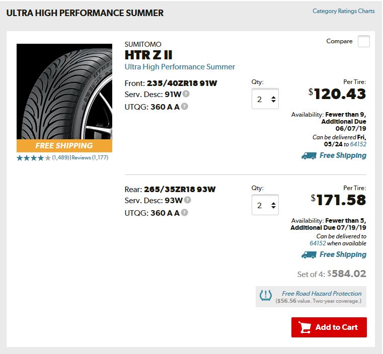

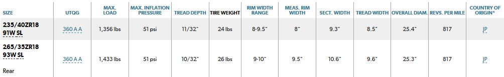

Get 235/40/18 front and 265/35/18 rear.
Want a decent sent of Summer tires without breaking the bank, get these. I run them on my car and love them.

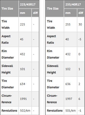

Yes, mount some fresh tires ASAP because 12 yr old tires suck! Ideal sizes for those wheels on a 986 are 235/40/18 and 265/35/18.
Pretty fun discussion on tire diameter differences though. "Twitchiness"??
All 987, 997, 981, 991 run 1" smaller diameter in front than the rear. It adds a little rake to the car so there is more weight on the front tires. This helps to generate excellent car balance in the corners. The idea that all these cars are "twitchy" because of the different diameter has never been discovered until now.
If your car feels twitchy, it needs an alignment.
