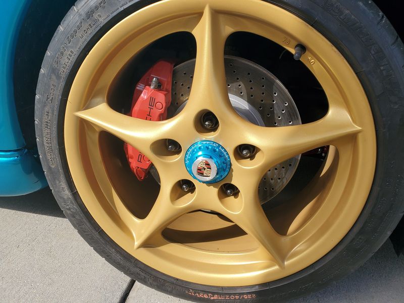

I've got curb rash on one of the wheels, and the others show minor oxidization. Clean and assess. And then I need to decide what to do with the center caps. They're horrible, and I think cleaning will make them worse. Haha

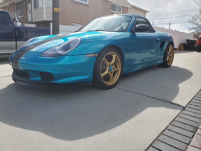

This has become a mostly-track-use car. DE's only, as I've promised myself no racing. (I spent waay too much money racing Superbikes for 20 years..... I won't do that again)
Around June of '18 I had a catastrophic clutch-failure at the racetrack. Holes in the bellhousing, etc.
In true-racer-form, I looked at repairs as a time to upgrade, so in went the AASCO LightWeight FlyWheel and new SACHS clutch. While I was int here I did a RMS and replaced a PERFECTLY-GOOD IMS.
I followed-up with a Underdrive Pulley so the Power Steering would get a break at the track.
Back out and had fun. Near the end of the year (October?) I took a spin and perhaps didn't get both feet in before it rolled backwards. I popped a plug outta the heads and the resulting inability to create vacuum meant the AOS was ingesting liquid oil straight into the motor. I shut down, but nt before the exhaust was saturated enough that it caught on fire. fun story. haha. Anyway.... back to the garage. I dug into the motor enough to discover I had what I think was a recent motor. it showed ZERO signs of being a 147k mile engine. And thankfully it wasn't broken.
Over the next winter, (2018-2019) I went through the car again, doing water-pump and thermostat, coolant, etc. I cleaned-out the debris between the radiators. I changed-out the oil in the trans and added the 2nd-gear detent fix. I also installed the 987 airbox and 78mm TB. To this I added the SOUL Muffler ByPass valves. Then I installed some FVD adjustable LCA's in the front and took it to have a proper track alignment done (with lots of camber).
The 2019 season was a fun one.... I had a lot of fun passing other "faster" cars. People say nobody wins practice, but I did. haha.
Middle of the year (July / August?) I was railing hard, when I noticed a little "rattle" at maintenance throttle, or right at pickup. I couldn't get it to duplicate it in the pits, so I went back out. It was ever so faint; enough that it was possible I was imagining it. But I had had enough fun for the day, so I picked-up and started the 30-minute drive home. 10 minutes into that drive it was over. The motor was done. Rod-bearing failure. I'm very certain it happened at what we call the "BlackRock Hairpin" at UMC. It's at the end of a VERY fast set of left-hand kinks (where I pull the most lateral g's of anywhere on the track) and then a short straight-away, then a hard-braking zone to a 1st gear left-hander. So the oil is all pushed-away from the pickup, then I'm zinging the down-shifts, way up in the RPM range, then pulling HARD through and out of the turn. Yeah.... poor guy... (the motor, I mean).
So I bought a crashed car with 80k miles and took the motor out of it. Parted the rest.
Over that winter (2019 - 2020) I installed the motor and did the following upgrades:
Replacement Transmission
Ohlins R&T "Track Package" Coilovers
Tarret GT3 sway bar & end links in front
Tarret sway bar and SPL PRO end links in rear
Adjustable thrust arms in front
Adjustable toe-links in rear
Remote-fob-controlled switches to manually turn on the engine-bay purge fan and the radiator hi-speed fans. (the same fob now controls the SOUL Bypass valves, as well)
Headers and Mid-Pipes
Cosmetically;
Replaced the door micro-switches so the windows would drop correctly when the doors opened.
Fixed the Foam on the doors in the A/C - Heater.
Wrapped the exterior with vinyl.
Added Joe Toth spoiler
Added SideSkirts

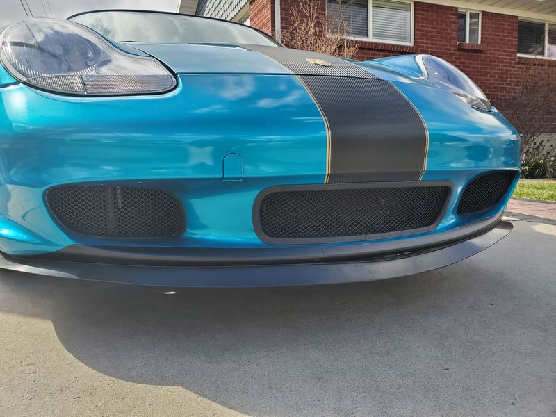

Added GT3 Front lip
Enlarged the center-hole of the bumper to increase air-flow.
18" wheels with Fred's center caps.
and Dozens of other little things.

So the Mod list looks like this:
Used Replacement 3.2L motor with:
UnderDrive Pulley
987 Airbox and 78mm TB & Plenum
LN deep sump & windage plate.
X51 Baffles.
Headers with no-cats.
MidPipes with Hi-Flow cats.
SOUL Exhaust ByPass valves (controlled by remote-fob)
Beluga-(ish) muffler. Yes, it now drones.
Suspension mods:
FVD adjsutable LCA's in front
Adjustable Thrust arms, front
Adjustable Toe-Links, rear
4-corner-balance
Track alignment
Cooling:
Remote-fob controlled engine-bay purge-fan and radiator High-Speed fans
Enlarged center-radiator opening

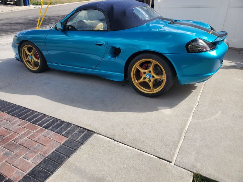

Oh I learned a ton about wrapping.
1. NOT a one-person job. you really need two people.
2. DON'T attempt this when the ambient temperature is below about 60d f.
There are plenty of compound curves, recesses, etc. on this car, which require a good understanding of how and where to stretch. And then how MUCH to stretch, before it tears.
The wrap is a 50/50. FRom 50-feet or at 50mph, it looks very exotic and badass. :-)
