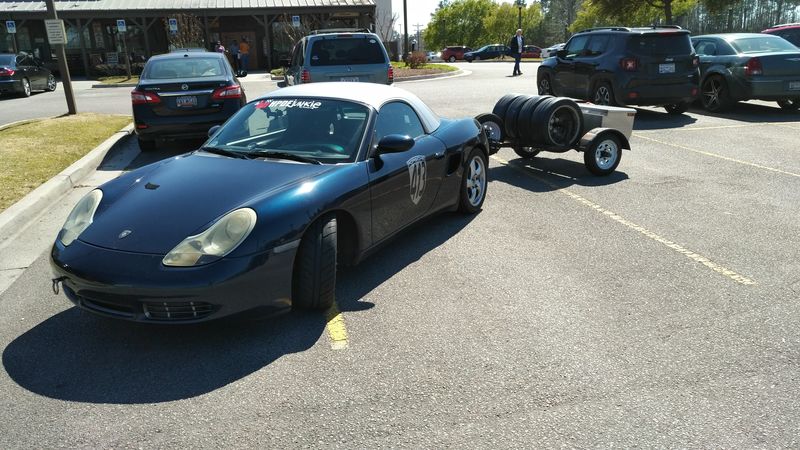

No exhaust rerouting necessary. The trailer chains can get hot though This is me, picture taken yesterday on the way to Carolina Motorsports Park.

A friend of mine used to tow that way in his Boxster before he moved to towing the whole car on the trailer. Had a plate welded on to an oem towhook and mounted a ball to that. My trailer hitch mounts to the bumperette points, i don't know if i would do the tow hole method or not, bit he did it. The logic is, if it is strong enough to winch the car up a trailer...

No coupon needed, my hitch came with my trailer, i think.it is the southsport hitch. I leave it on all the time
