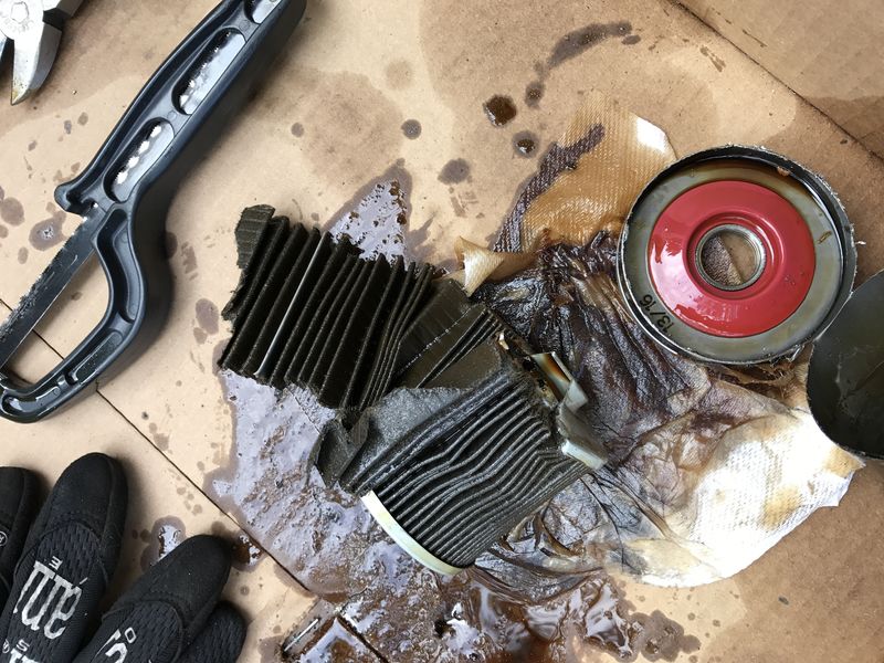

Just took apart the oil filter and no metal shavings at all!!
Rok986 is offline   Reply With Quote

If you have fuel pressure it could be the crank position sensor. Good to hear that no metal was in the oil filter.
