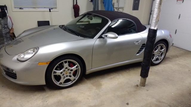

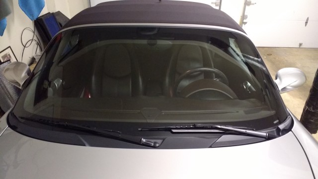

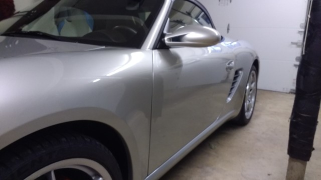

And for the record, Im sorry I got mad. I just asked a question. I am new to this forum and to Boxster S cars this year and I know you guys have been doing this for a while. I have been a vette, mercedes guy.
I have an 02s i am selling on Monday and I bought a 05 987s. Im looking to do the ims on it, it has 26k orig miles.
jrebot2 is offline   Reply With Quote

Very nice looking car. Best of luck with it.

Yeah, same here. I can be a bit blunt, but we are all in the same boat. Sorry about that. My point in my first post was that debates over the IMS options get ugly quick and I (and most here) prefer to keep things light and avoid confrontation...which I failed at miserably in this thread, haha
That's a beautiful 987 and don't feel like you aren't welcome here. The 986 and 987 are still very similar and there are plenty of guys here with the 987, so plenty of help and discussion to be had.
