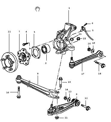

Hey @Pdwight / @AaronPDX / j.fro and anyone else that's done this... I also have a clunking back end (hehe) and just want to check that the part you replaced to fix it was #8 in the diagram below...?
Several seemingly random variations on the 'Control Arms' name seem to be used interchangeably between parts #8, #9 and #17 depending on where I'm looking, so want to be sure I buy the right bit!
Thanks!

Hi oldskool, yes I replaced #8. You'll also see that referred to as trailing or track arm sometimes. I was able to diagnose it by hitting it with a rubber mallet. Instead of a dull thud, it made a metallic noise. However, dghii is correct. It could easily be your drop links.
2000 Boxster S 6 speed Guards Red

Update : I replaced both trailing arms in the rear with TRW parts (shipped from UK to Oz and still half the price of buying here!), all the banging over bumps is gone, I'm happy!
