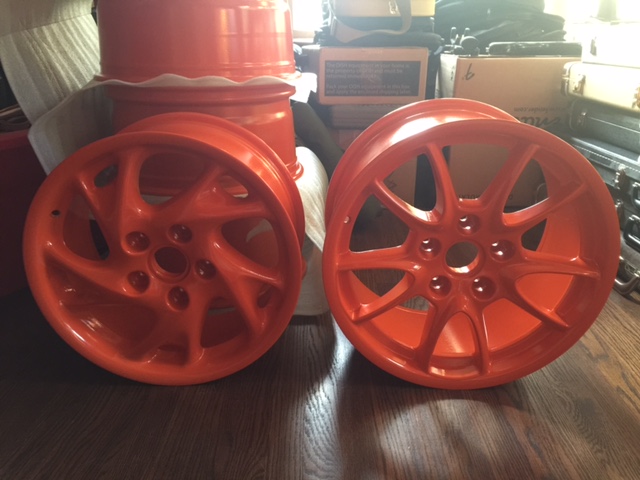

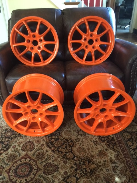

Hey Guys - I need some help with tire size for my new wheels, and also suggestions on brand/model.
They will be going on my '99 aerokit Boxster that I use some for street, but is mostly my DE car. My goal is stickiness and performance, not wear, but I'm not ready for a R-compound tire. I'm also not worried about all season performance - summer only is fine. The wheels are a GT3 replica wheel. Fronts are 8 1/2x18 52 ET, rears are 10x18 54 ET. I'll probably have to run 5mm spacers. I have the spacers and the longer lugs.
I'm thinking 225/40/18 for the front and 255/35/18 for the rear, but I'm not confident the rear size is correct.
I ran Re-11's this past season and was mostly happy with them. I'm also looking at Potenza Re-71R and Potenza RE 760 Sports. Also Potenza S-04.
No preferred brand, so I'm open to suggestions.
Thanks!
Rick

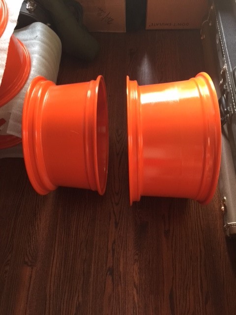

Hey Guys - all good info so far. I appreciate it.
I did forget - the car is sitting factory US spec M030 suspension. When I had the suspension freshened this past spring, I had the shop set everything to factory M030 numbers (castor, camber, etc).
I do have some concern about the car pushing an 18x10 rear wheel. It does look awfully big sitting next to a factory 8.5x17. I may be defeating the whole purpose of what I'm trying to do with making myself faster and the car more stable/neutral. Thoughts on that?

I think a 10" rear wheel is OK, I have heard that 11 is where you get into a lot of trouble.
