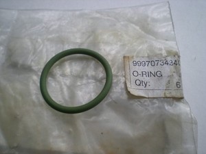

Happy Easter Folks,
Sooooo, I did an oil change last week and found the stuff you see in the photos nestled in the filter media. It is green in color. It feels firm but is a bit mailable (I hammered it out on a pies of steel and it can be pounded flat without shattering). A freind of mine has said it's cam chain guide material, but I never seen that present as green...and it's very green; it looks like finely chopped capers. Oil has 6000miles on it, filter has 12,000miles (got to the hangar and realized I was out of filters for the last change).

Looks like the same material as the cam end plugs.

That occurred to me as well, but there's so much of it.

there's also valve stem seals
spark plug tube gasket/ o-ring

The new style chain guide material is light green.

That could have happened in the last 1,000 miles or 12,000 miles. Whatever caused the debris its not good news.
1) Could your engine have the later (green) chain guides - if so, thats possibly the problem, though the gude plastic is not a soft material.
2) Probably not the camshaft end plugs, if one or part was missing you would have oil leaking everywhere.
3) Valve guide seals would also leak oil into the combustion chamber and engine would smoke.
4) Good call on park tube O ring, have they recently been removed - check for possibe leaks around valve cover.
Maybe time to remove the sump and check for debris in the oil strainer and bottom of sump cover. There maybe other clues in there.

This color material comes from the inside of the hydraulic servo on the 5 chain variocam arrangement.

There's a pair of seals inside some of the servo units. To gain access to them the unit must be cut open. When they start to fail the material will contaminate the oil.

Not surprising.. If they attended my classes, they would know about it. Unless someone dissects the unit they will never understand this. Most shops have done nothing more to these engines than re-seal cam covers.
When this seal fails ultimately camshaft deviations will occur as the adjuster will no longer function. Its not catastrophic, but when it goes long enough it will set a CEL and account for crappy gas mileage.

The bank with 6.5 degrees is the unit that has emitted the pieces of debris.. You have about 2.25 degrees more before it sets a CEL for being out of range. The 6.5* is already costing gas mileage, adding to the rough running index and adding fuel trim.
The servo units are not serviceable and thats why no one else has found the source of the debris, because they have not cut the units open. As a researcher, doing the things that no one else does and finding the things that no one else has found is my job.
If a unit fails, just replace it.
BTW- a failed servo for the VVT arrangement is mode of failure #5 of the 27 documented modes of failure for the M96 engine.
