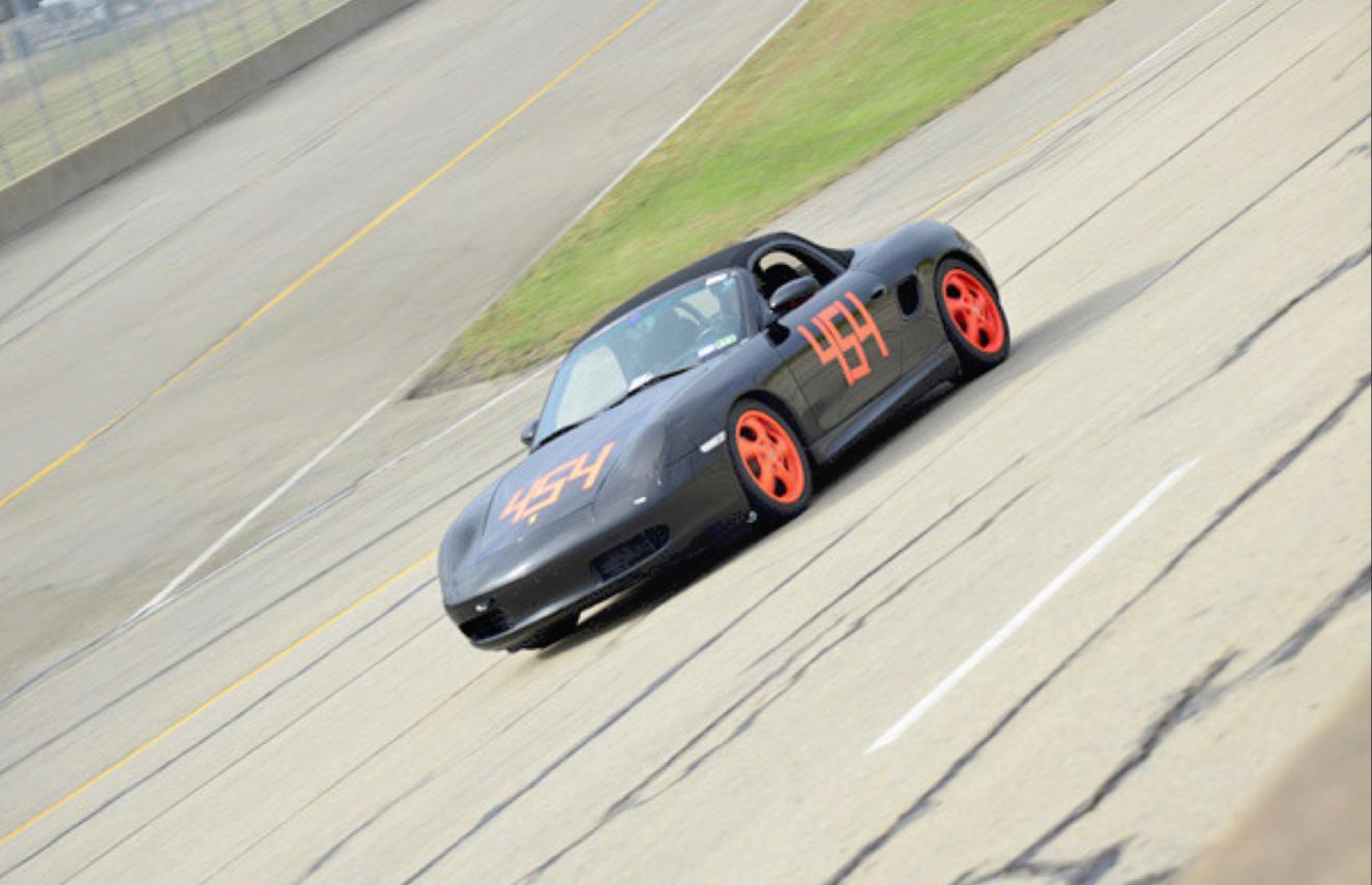

I used some bright orange racer's tape at the track this weekend for my numbers on the frunk and doors of my black Boxster. When I removed the tape on the frunk, all the residue came off easily, but the reinforced tape pattern did something odd. The paint was indented showing the pattern where the paint heated up at different temperatures.
This is permanent damage I think. I will attempt to buff it out by heating up the paint to smooth it out, but I don't hold out much hope.
Word to the wiser than me here... Use blue painter's tape and avoid my mistake.

Yes, good tip! Racers tape, otherwise known as duct tape, has quite a bit more adhesion and isn't intended to be easily removed. Hope it all cleans up.
By the way, I really like the look of your car. My Spec Boxster race car is going to be black and I've been thinking about color combo's and had this in mind. Now I can see firsthand what it might look like. Thanks.

Man that's some serious banking...
Give it a once over with a cutting pad (usually the maroon pad) and an intensive polish.
I doubt it etched clear past the clear coat.

Guys, this is not tape residue I'm talking about here... The temperature differences under the tape actually made the paint surface ripple. Just thought I'd add this clarification.
This is similar to what happens when a bird craps on the hood of a black car in the sun. The paint under the bird crap is hidden from the sun is cooler than the paint surrounding it and it creates a bird crap "etching" outline. It's not the acids doing the damage. It's the temperature differences on the paint causing the damage.
It's an old NASCAR track. However, I think the photographer made it more dramatic than it really is.

Orange looks cool. Fluorescent green/yellow would look sweet on black .
