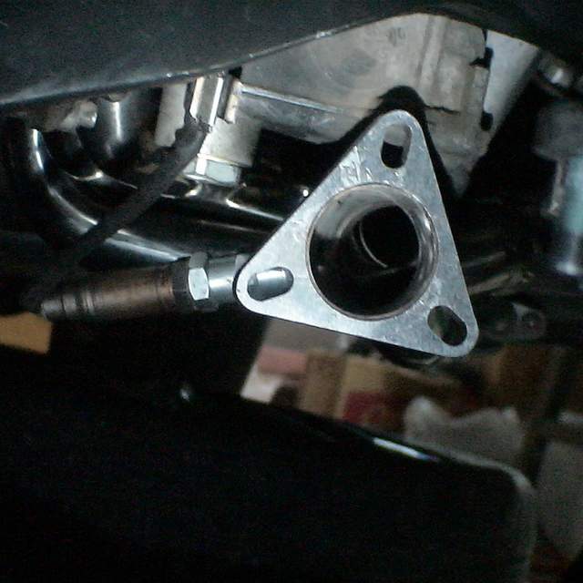

Here's a pic of the right (passenger's) side view from behind. Is it hangin' too low?
Is the O2 Sensor and "Spark Plug Anti-Fouler" setup dangling down too far? The second O2 Sensor is the after cat sensor but now has become "my catalytic converter" using the Anti-Fouler trick by getting the sensor out of the exhaust flow. I have read differing reports. So I though I would give it a try this way first.

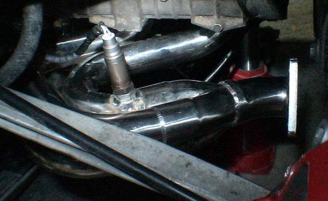

Here is a shot of the primary (or first) O2 sensor. Sorry about the photo clarity - it is hard take a pic when you are jumping up and down! :dance:

Will this wire pose a problem on the left side? The O2 sensor wires are tighter than a "Baywatch" string bikini!
No CELs were incurred - since it is not out of the driveway yet.

The wires being that tight will cause a problem sooner or later. It also appears too low, but It's hard to tell without all the covers and such in place.

I ran like that for awhile. The o2 wires did get scraped once, but not badly. The extensions will extend your time without a CEL, but it will eventually come on. I tried a couple of things, decreasing the size of the hole in the extension, and also blocking it completely, but nothing fooled the ECU and I always got the CEL. I eventually forked out for a Softronic tune, and that worked great.
If you ever Dyno your car, I'd love to know how your air-fuel ratios look. Mine have come back lean a couple of times.

Is you S1 harness pulled tight against the block, with nothing protecting it from rubbing through?

I am running catless, or trying to. Just put in the headers. Have a Top Speed1 Cat Bypass & Cat Back Exhaust system. It felt and sounded good before, can't wait to see what the headers do.
Hey @j.fro,
Sealing the O2 sensor extensions was what I thought would work, since it reduces the airflow over the O2 sensor. So an "L-Extension" definitely wouldn't work? If I have to go for an ECU flash, what does it run? Why were your ratios off, from the headers, the flash or intake?

I have found a way to "give the wires some slack". The O2 sensor wires each plug or clip into a plastic sensor block attached to…well, the engine block. It is held in place by a small bolt. I merely undid the bolt and attached it using zip ties - nice and secure in multiple places (so it won't rattle or become loose).
