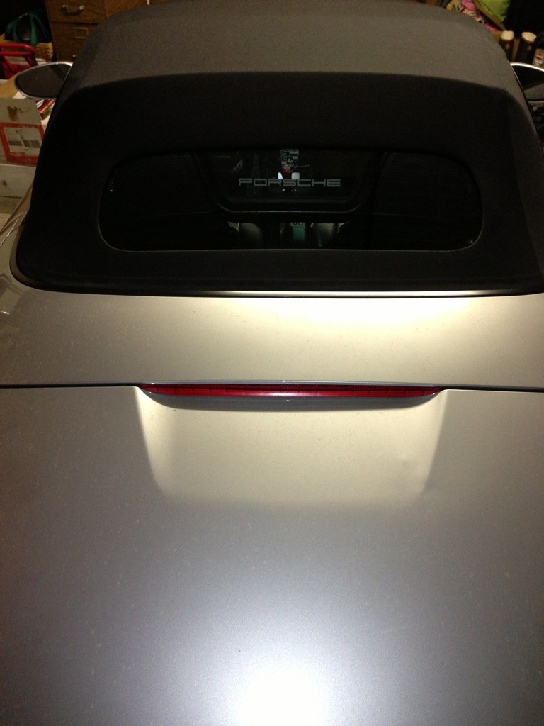

New glass top installed over the long weekend!
This has been on my long list of things to do, but has also been the one I was most dreading... The plastic window had a few stress tears where it folded and was sewn, plus it was getting hard to see out of clearly. Also, it's been leaking water when it rained from several places other than the obvious plastic tears... It would stink in the car a day after it rained. The back storage compartment's cubby behind the driver headrest would have water just sitting in it. Took me awhile to find where it was wet inside... Obviously leaking from the top upper plastic window.
I've had the replacement top from autotopsdirect.com for awhile, but was just putting it off and waiting until I had some time (and the courage). Finally had this past Friday off, so I figured 3 days was long enough and tackled it. It looks so good and I'm very happy that I went with the glass instead of plastic. I'd read a lot of pros/cons and am very happy with my choice.
The removal and installment went really well and I was able to do it by myself. I can't say how many hours it took me because I really spread out the work over the weekend. If I got to a point where I was starting to get frustrated or needed a break, I would just stop. If I had to do another one, I feel like it would be more of a breeze, as I would be more familiar with the process and know what to expect and how it goes together. It wasn't hard, just unfamiliar work. If anyone has specific questions about it, let me know.
I'm very much looking forward to no leaks, no musty smell (if was def the top, not the drains), seeing clearly out of the window, defrost, no chop, no worries of the plastic cracking in cold weather.

Hey Meir,
When I purchased my top from autotopsdirect, they granted me access to their 40 page install pdf document. That's really all I used... Don't get too intimidated by the install. Just take your time and you should be fine.
Regarding the foam strip, I don't see a need for it. The new top comes with a cardboard type piece that gets glued into that front channel.
As far as the plastic rivets that Pelican mentions: YES, this was my experience as well... In my install, this part was the most difficult part for several reasons. The "how to" from autotops is great, except for the steps involving this part. They don't have decent pictures (a diagram would've been nice) and it lacks a good explanation of what you're trying to do. Getting the top both on and off this part was the most frustrating part. This is where a little experience would come into play and more research than I did.
If I had to do it over again, I would buy new plastic pieces with the rivets just to have a new part since they are so fragile. Mine were slightly broken before I even touched them, so either someone in the past had messed with it, or they are that fragile just sitting there... My experience says you're in there anyway, if they are relatively cheap parts, might as well replace.
The biggest tip I have is to take those pieces completely out for the install. Autotops suggests that you just take out the one screw that holds the tension cable in, but I would also take out the screw on the opposite side of it and pop the 2 rivets out, and pull the piece up and out. You are supposed to fold a flap of canvas under that piece and it's just too difficult to get to with it on the car. So I say, take them out, slide the new canvas into the slots, fold the canvas/plastic end under the "J channel" and hold that part tucked under as you reinstall the plastic piece. Then pop the 2 rivets back in, and screw in the front screw with the cable eyelet as well as the rear screw that holds the back of that plastic piece in.
I hope this helps/makes sense. It will once you are involved in the removal/install.
If you don't get new plastic parts, don't sweat it, just be careful and mindful when you pop them out. I don't think Porsche would've engineered them to really hold much on their own being plastic. It seems the tension of the top itself really hold the parts on. So, if you get new parts, great, if not, don't worry, just be mindful. I'm just basing buying new on hindsight and "while you're there" mentality.
As far as parts, no, it comes with everything. Your autotopsdirect pdf will give you a list of tools you need. Just the 3M yellow spray adhesive. Autozone carried it. Just make sure you get that exact adhesive. Other than that, rubber mallet or hammer if you're careful, scissors, torx drivers, screw driver (flat and Phillips), an pliers. You will need a longer torx 25 driver (I believe) for that aforementioned plastic part. I had just a short collapsible set and it was too short to get to that front cable screw. Also, the new cable eyelets needed to be made larger to fit the screw, and it was easier to drill the hole in the canvas rather than using a pick like they mention. So I used a drill bit and driver for both. Worked great.
Again, hope that helps anyone's install.

Yes, that's exactly correct. You'll need 4 of #13 and a left and right of #12. Do you have a price for them? I'm just curious. Again, if they're not $, I'd just get them. My car only had 1 of the #13 part still on the car. I have no idea where the other 3 are. It really holds fine with the old parts, but again, while you're in there...
To anyone else, part #11 just sits under part #12 and should be fine to use again.

I'd also like to add that today was the first day I drove my car around with the new glass top, and I just wanted to add that I'm so happy that I went with glass. I never realized how much I couldn't see out of my plastic window. Backing out of the lot at work, I'd kinda forgotten about the glass and was a little startled that I could actually see out of the back. So worth it to upgrade to glass.
I'm a tall guy at 6'3" and I can't see people's faces in the cars behind me, just to give you an idea of the loss of vision. I can see cars easily and feel much safer on the road than I did, just is a smaller window by 6" top to bottom and 2" left to right. So it's different, but so much better, IMHO.
