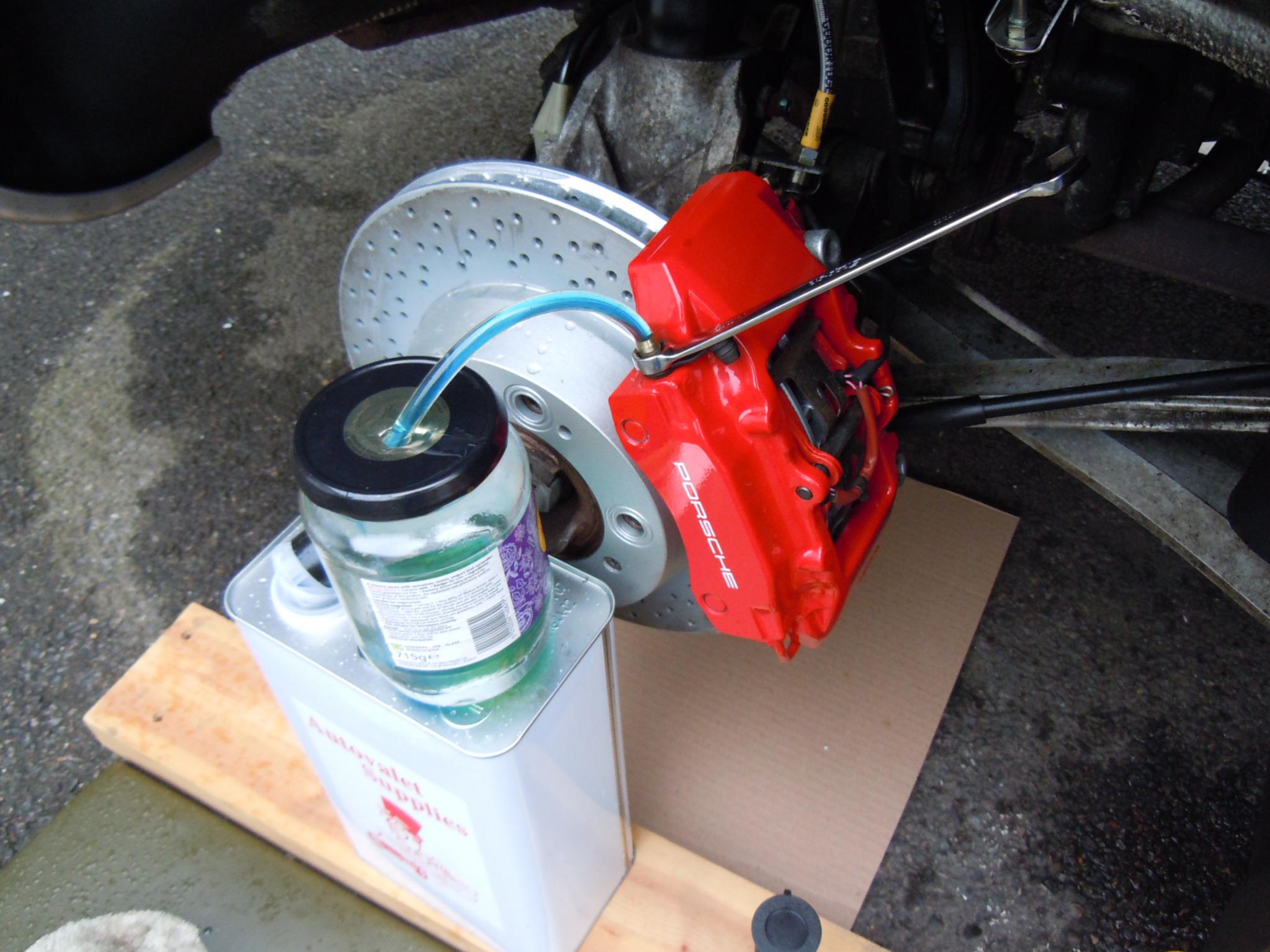

New rotors fitted and Red stuff pads to the rears, along with Goodridge lines
So armed with my new `Motive Brake Power Bleeder` recently imported..got on with the task of bleeding the brakes and doing a full brake fluid change while i was at it..
Armed with 4ltrs of Ate Blue racing fluid...complete overkill !!!! Didnt take more than 1.5 ltrs...so where i read 3-4 ltrs is complete rubbish.
Existing fluid was gold, so changing through with the blue made it easy.
The Motive Bleeder worked well...but you do have to keep pumping up the pressure

You're supposed to keep the pressure around 20. I'll usually bleed one wheel and then go pump it back to 20 before starting the next one.

Yeah was doing one wheel at a time and keeping the pressure at 20..
2 bleed screws per caliper of course.. good tool though..and very easy to use
Just took 1 fill up of the bleeder and done it all...poored about 1 1/2 litres in and had a bit left over...so a complete fluid change was around 1.4lt at a guess..
