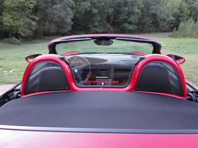

If you don't mind a painted plastic cover you can do what I did:

I got them for a member on the forum that used to advertise here. Not sure if he still sells them. I'll PM you his email address. He even dropped them off at Bumperplugs who painted them for me.

What is it exactly that you got , a plastic cover over the entire back of the roll bar? Can you PM me also I am interested as well..

I painted my pads. The front side, not the back 'overlays'. They pop off pretty easily, be careful not to damage the clips inside of the roll bar. A few coats (i have about 6) of vinyl paint and they are good to go! A great looking mod.

Whip what are your thoughts on the quality of the plastic covers? I am curious especially as they seem to attach with strong double sided stick tape and I assume that is hard to remove...

The quality of the plastic is good. It's the quality the paint job that matters the most. I got a great paint job and it paid off. The roll bars on my 987 are painted from factory and they look awesome, obviously the overlays aren't that good but from behind they look sharp.
