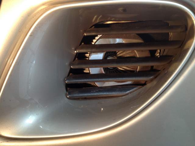

Google cayman cold air intake. There is a product out that mounts an oval cone filter in the fender- very easy to fab yourself.

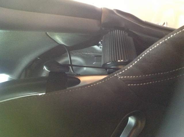

For those of you wondering what the stock air setup in our cars are like:
What Homeboy proposed certainly has merit, and some people already have a set up like he proposed. I would be surprised if you didn't manage to free some horsepower. Personally I would love to hear the growl of the castrated engine with such a set up!
