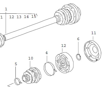

if my memory is not failing, I recall another thread in this forum that talked about noise due to crushed plate where the inner CV joint attaches to the transmission output flange.
there was a photo with a dimple and the piece should have smooth dish-like feature. I believe it was item 11
