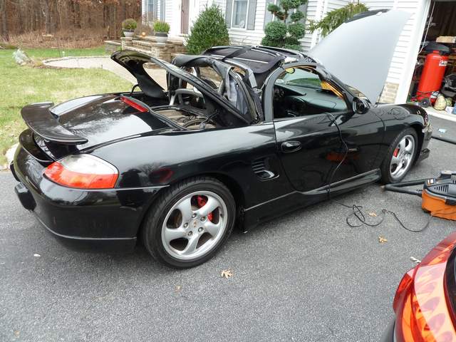

And the old top is off. My body aches with all the reaching out and bending. Wasn't that challenging but, the Pelican steps are missing some critical details. Figured it out by thinking patiently. Gave the engine a good wash while I was in there.
Now waiting for the goodies to arrive tomorrow - top, filters, brake pads, fuel filter etc. Should be a fun weekend.
