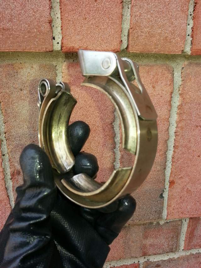

Her is a few pics of my clamp that I think is causing me problems. Slight leak i'm thinking. Those clamps mentioned earlier wont work ends of these pipes.
Second clamp is one I got from Summit Racing. Any alternatives to these?

Thanks for the reply. Took a look at those clamps from the link and they are flat. The connection from the mid pipes to the muffler are raised and rounded. The pics above has a groove in then for it to seat well I guess. I will give thise guys a call on Saturday see what they say. Happy 4th guys.
